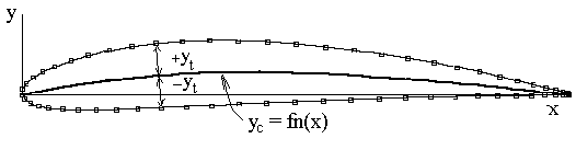

does anyone know how to calculate the second moment of area of a typical quadcopter arm like this? what should I approximate the cross section as?

yes, I want to calculate the overall stiffness of the arm. from here https://www.engr.colostate.edu/~dga/mech325/figures/elastic.pdf , there is a equation for the stiffness of a loaded cantilever beam that involves knowing the second moment of area.but its for uniform cross section.
So do I assume the quad copter arm has a constant cross section or is that too much of an approximation?

You can calculate the second moment of area of the foil section for the copter blade, but it would be really tedious to do if you don't know the offsets of the foil section:
Given that the individual blades are not prismatic, the difficulty in calculating the stiffness will not be confined to just evaluating the second moment of area.
It would probably be a more effective use of your time if you simply tested a blade by applying a known load to the tip and then measuring the deflection.
Ditto if you are talking about the arms which connect the drone body to the thrusters.
With curvy, swoopy bodies like this drone, beam stiffness is no longer a useful concept to apply, and not just because of the difficulty in calculation.

If you have CAD software, draw the 2D shape, convert it to a polyline or region, and invoke the property inquiries command. That should output values for "area, perimeter, centroid location, and 2nd moment."
On a cantilever beam, you can usually assume bending moment goes up as the square of distance from the tip, so you only need to investigate bending at the root end of the arm (where it attaches to the center pod).
