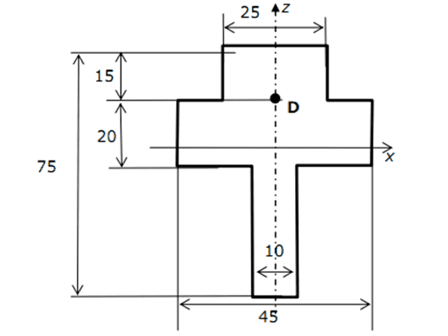

A vertical column has the horizontal cross sectional area shown in the attached image. The column carries a vertical compressive point load of 30kN applied at d. calculate the following:
a) The second central moments of area IZZ and Ixx
b) The maximum values of compressive and tensile stresses
c) The position on the cross section where the stress is zero
I have done part a and got:
Ixx = 5.48E+5
IZZ = 1.75E+5
for part b i know the formulas for compressive stress and tensile stress. However they require a bending moment number. How do i calculate this?
Tensile = Mzc/Ixx
Compressive M(zmax-Zc)Ixx
Compressive stress due to point load F/A
C) I am not sure how to complete this part
Any help would be much appreciated

Hint: Neutral Axis
zc = 46.75mm and xc = 22.5mm. Is the bending moment calculated from these?
I have been trying to work out the bending moment for a while now and can't seem to get the answer of 3.97E+5 Nmm
Remember, take your moments about the neutral axis.
I am also stuck on a very similar question and i don't know how to calculate the moment. I assume the neutral axis was at the centroid of the shape which I would work out to be 46.3 mm. I have been looking for days for help on this and I'm getting nowhere
Do you need to draw a bending moments diagram??
Bending moment is M= mass x distance between the (load point D - Zc).
The position of zero stress (Zo) is basically,
Zo=total tensile stress x total length of z-direction( I beam)/total tensile stress + total compressive stress.
