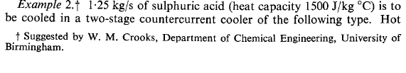

I'm stuck on a problem:

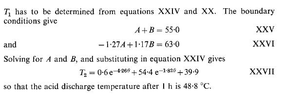

T1 = dT2/dt + xT2 - y
T2 = (Ae^(-4.26t))+(Be^(-1.82t))+39.9
I'm unsure how to proceed
I was able to get XXV by setting T2 = 94.9 @ t = 0 and putting this into XXIV, but I'm stumped with the other boundary condition result in XXVI
Can you please provide the original problem statement?

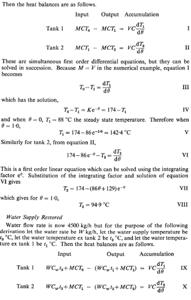

Problem statement below. Final two pages in posts #2 & 3
Note for XXIII, I got 159.6 for the right hand sided term instead of 309 (see post #2) although the coeffcients remained unchanged
I would never have solved this problem the way that they solved it. The first thing I would have done would have been to solve Eqns. 19 and 20 for the final steady state temperatures in the two tanks and large ##\theta## (##T_1(\infty)## and ##T_2(\infty)##), when the two time derivatives approach zero. Then I would write $$T_1=T_1^*+T_1(\infty)$$and$$T_2=T_2^*+T_2(\infty)$$What do you get for the final steady state temperatures, and what do you get when you substitute my Eqns. 1 and 2 into their Eqns. 19 and 20?

I get $$C\frac{dT_1^*}{d\theta}=-\left[C_W(1-\alpha)+C\right]T_1^*+C_W(1-\alpha)(1-\beta)T_2^*$$ and $$C\frac{T_2^*}{d\theta}=CT_1^*-[C_W(1-\beta)+C]T_2^*$$
Note, that, in terms of the asterisk parameters, there are no constant terms in these equations. Initial conditions are $$T_1^*=142.4-79.3=63.1$$and $$T_2^*=94.9-39.8=55.1$$
Does this make sense to you so far?

We are going. to first solve the two homogeneous coupled differential equation in post #19 subject to the initial conditions: $$T_1^*(0)=63.1$$ and $$T_2^*(0)=55.1$$If we substitute these values into the two differential equations, we can obtain the initial conditions on the first derivatives of ##T_1^*## and ##T_2^*## at time t = 0: $$\left[\frac{dT_1^*}{dt}\right]_{t=0}=-3.094T_1^*(0)+1.489T_2^*(0)=-113.2$$ and $$\left[\frac{dT_2^*}{dt}\right]_{t=0}=T_1^*(0)-2.991T_2^*(0)=-101.7$$
The next step is to solve the second equation post #19 for ##T_1^*## in the 2nd differential equation in terms of ##T_2^*## and its first derivative: $$T_1^*=\frac{dT_2^*} {dt}+2.991 T_2^*$$We can then eliminate ##T_1^*## by substituting this into the first differential equation in post #19: $$\frac{d^2T_2^*}{dt^2}+2.991\frac{dT_2^*}{dt}=-3.094\left(\frac{dT_2^*}{dt}+2.991 T_2^*\right)+1.489T_2^*$$or $$\frac{d^2T_2^*}{dt^2}+6.085\frac{dT_2^*}{dt}-7.7652T_2^*=0$$The solution to this homogeneous linear ODE is of the form ##e^{\lambda t}##, with the two exponential terms satisfying $$\lambda^2+6.085\lambda+7.7652=0$$The solution to this quadratic equation for ##\lambda## is $$\lambda=\frac{-6.0850\pm\sqrt{(6.0850)^2-4(7.7652)}}{2}=-4.2638\ and\ -1.8212$$So, $$T_2^*(t)=Ae^{-1.8212t}+Be^{-4.2638t}$$where A and B are constants to be determined from the initial conditions: $$T_2^*(0)=A+B=55.1$$and
$$\left[\frac{dT_2^*}{dt}\right]_{t=0}=-1.8212A-1.4638B=-101.7$$Solving these two linear algebraic equation for the constants A and B gives: $$A=54.3$$ and $$B=0.8$$So, we have $$T_2^*(t)=54.3e^{-1.8212t}+0.8e^{-4.2638t}$$The solution for ##T_2## is then $$T_2=T_2(\infty)+T_2^*=39.8+54.3e^{-1.8212t}+0.8e^{-4.2638t}$$
