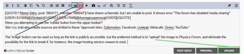

Were you attempting to use the 'media' button from the upper toolbar?
Site help indicates media sources are limited to these "approved sites: Dailymotion; Facebook; Liveleak; Metacafe; Vimeo; YouTube;". I haven't tried and verified it, but using the media button to link out to anything else could well generate a 'forum has disabled media sharing' error message.
The 'image' button can be used so long as the link is publicly accessible, but the preferred method is to "upload" the image to Physics Forum, and eliminate the possibility for the link to break if, for instance, the image hosting service ceases to exist.
