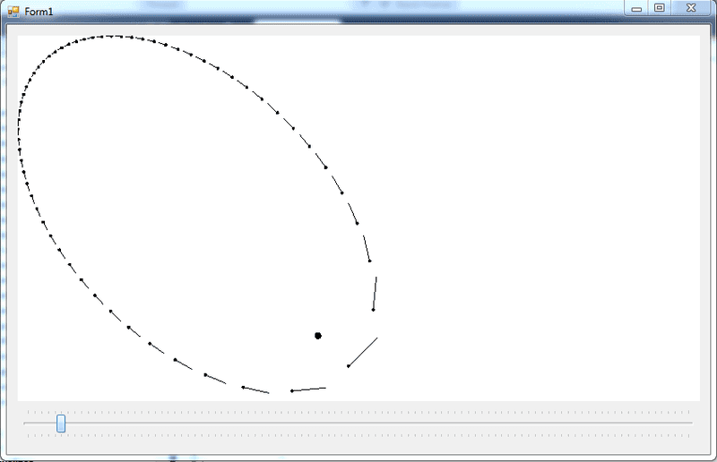

Thank you for all your help! I actually have it working in 3D now, that's just my flattened view for debugging. I can calculate position, speed, directional vector up to a given accuracy for the sattelite. In the image above the directional vector is the speed scaled by a factor of 100 so I can visualize it.
Was quite a challenge for me. :)
It's important to give back, so for any other non-math-genius programmers, here is the code, highly commented. I won't bother you to help me any further, but if yer bored/interested in glancing at the comments, maybe you can tell me if my terminology or description of what's going on is incorrect. I don' think it's buggy, as it seems to work.
The vector math is just my naive implementation once I have the 'hard' math handled. I'm sure there's a more direct way to get the vectors in 3d, but this works. :)

@Bane1998
The above formula is probably the best to start with. I once used this formula for simulation of a few planets, with ONE BIG problem, I'll explain later. This is how I used the equation.
a) Solve the equation for 'r'. r is the radial distance of ,say, Earth from one focus of the ellipse.
b) compute 'x' and 'y' component of 'r'. This 'x' and 'y' are the coordinates of the center of Earth (planet). Draw the planet at this point.
c) You have to get from online the accurate values of 'e' and and semi-major axis 'a' of each planet.
d) Note, you'll be incrementing the angle from 0 to 360 degrees in simulation.
Now the Problem:The graphics work beautifully but against Kepler 3rd law. When the planet is closer to the sun, its velocity is slower, when the planet is farther from the sun, its velocity is faster. IIRC, Kepler's law says exactly the opposite.
Anyone here knows how to correct the simulation for velocity?
