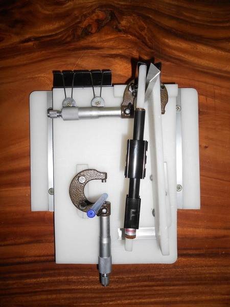

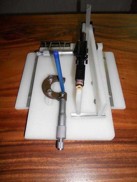

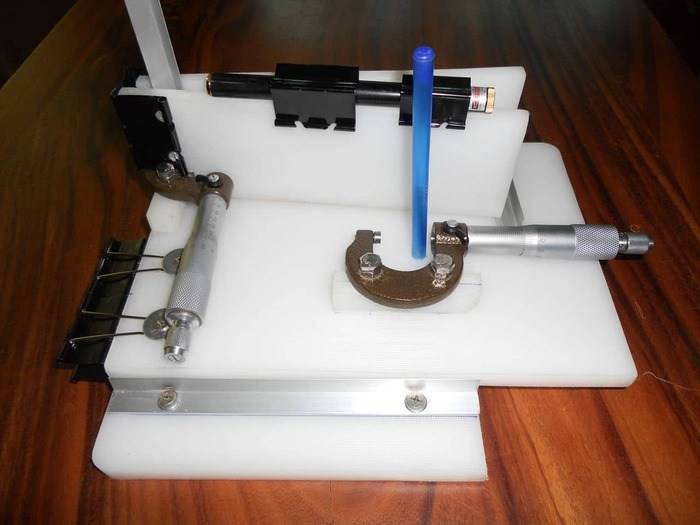

Got the aiming device 'finished'. it's untested on a tripod as yet, but works well sat on a 2nd-floor, flat, outdoor wall-top and aiming at distant objects - trees, etc.
There's a small backlash movement when moving the laser dot horizontally, and the crosshairs formed by moving the dot left-right-up-down against a drawn target at 5metres are slightly tilted.. maybe 2 degrees clockwise, but that's an adjustment for tomorrow.
Cheap mikes and springs, kitchen chopping boards, aluminium angle, pen body, allen key, drinking straw.
Inch adjustment at hundreds of meters.

What the heck IS that thing??
I'm starting to get the idea. You use the left calipers to make fine adjustments on the horizontal axis.
But I can't figure the foreground calipers. They push on the blue stick. I can guess that they must adjust the Y-axis, perhaps by pushing apart the top bard from the bottom, but I don't see how.

Evening, Dave.
My first concern when the idea of pointing a laser so far was raised was accurately gaining control of the pointing of the laser, and doing so in a way such that any movement was as repeatable as possible. I'm pretty sure that I won't see reflection of the beam back to the sending point, so spotters will be radioing or on the phone - waiting for a red flash from my location. I'll narrow a series of sweeps down until I can nail a position.
The calipers are micrometers (mikes) - they're used to measure size. These have measurement lines marked at 0.01mm, but can quite accurately measure in 0.0025mm increments - judged between the lines.
I use the mikes to move the laser pointer in both the horizontal and vertical planes.
As you can imagine. a movement of 0.0025mm at the mike gives good control over placement of the laser at a distance.
You've got the horizontal movement already - one of the two smaller-sized white blocks set in a wedge shaped V moves towards the other - pushed by the mike and repelled by the spring-steel of the bulldog clip riveted to the back - pivoting around the vertically placed aluminium 90 degree angled channel.
The vertical movement comes from an allen (hex) key placed upward through a hole/slot in the top plate. The long arm of the key points upward through the plate and the short arm of the key points toward the back of the device under the top plate.
When the mike pushes the allen key, the key tilts, and thus the key's short arm acts as a lever that pushes up the top plate. There's a lot of friction between mike and key, so I placed a blue biro shaft/body over the key - this is oiled inside and rotates around the key as the mike turns, vastly smoothing movement . Look closely inside the blue pen in the bottom photo and you can see the allen key.
Under the key and on the contact point with the bottom plate is fastened a large metal washer. A cropped drinking straw covers the short arm of the allen key here to remove some friction when contacting the washer, and the washer is also oiled.
