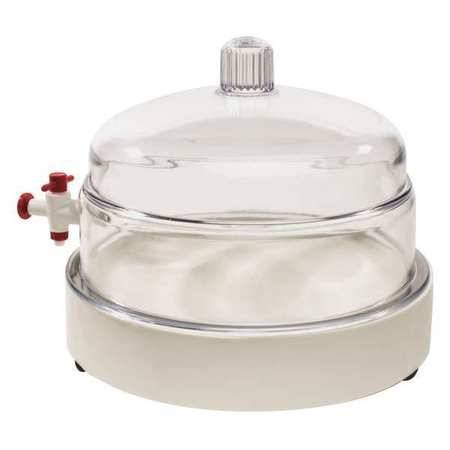

I'm looking for a cheap, wide mouthed jar capable of withstanding moderate vacuum (up to 29-30" Hg). The jar I've currently been using is like http://packagingoptionsdirect.com/8-oz-french-square-clear-glass-bottle-028047?gclid=EAIaIQobChMIqMnmme_g2gIVgUSGCh3frw2_EAQYAyABEgKgG_D_BwE one with a rubber stopper and plumbing valve in place to hold vacuum once evacuated, which works well, but I now need something in a 3-4" width but not any larger really (no more than 16 oz size). A first thought is a Mason jar with a suitable rubber stopper for the top, but I don't know if they could attain and hold that sort of vacuum for a month (the French square jars easily do). Budget is limited, otherwise I'd just have a suitable vacuum desiccator chamber. The French square jars come up to 32 oz at good prices, but the mouth still isn't wide enough. Thanks in advance.

And even though you are on a budget, for less than $120 you could get a standard Bell Jar that would probably be a lot safer for your experiments...

I looked into the vacuum chambers, such as the one you shared above, but most reviews seem point to the fact that they won't maintain vacuum for more than 24 hours and I need something as described above.

To protect against any implosion, you could put your vacuum chamber in a 5 G plastic bucket with a top with holes drilled in it for the hoses/tubings. The buckets can be obtained from places like Home Depot or Lowes for <$10 usually. They are quite strong.
The kind of glass has an effect on the strength of the container. Pyrex and similar glasses are pretty strong. I have used them for tissue culture media sterile filtration.
You could also get polycarbonate or related plastic (acrylic is kind of brittle in comparison) containers from restaurant supply stores.
Price will vary with size and you are more likely to find something like a straight edge beaker rather than a bottle. They would require a larger plug, but provide a larger opening/volume.
Round is usually stronger than square containers.
I have used vac chambers similar to the one pictured above and they definitely kept the vacuum pretty well. It may be that the seal at the bottle or in the valve need to be re-greased (with vacuum grease ideally) to maintain the vacuum.

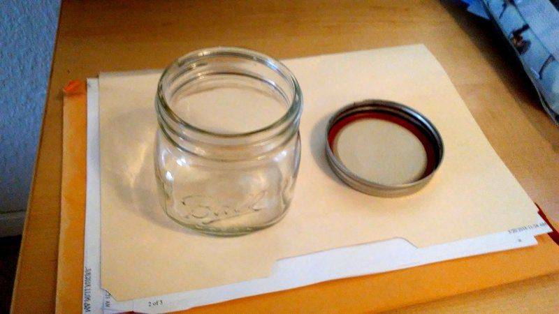

I don't know if this helps, but if you start with a standard Mason Jar like in the picture below, one of the issues is the strength of the flat lid against the vacuum pressure force. You might be able to craft a single support pillar in the middle of the jar to brace the lid against excessive bowing inwards.
You would need to drill a hole and mount a hose nipple in the lid, but I've done something similar for my brake bleeder setup. The pillar would restrict the volume a bit for your larger spiders, but maybe it could be made to work.
I still would recommend integrating a plastic overall enclosure for implosion protection, maybe smaller than the bucket and more easily portable to put into your freezer. I just don't trust bare jars with potential explosion/implosion hazard issues.

I actually have some rubber stoppers on the way that I think will fit the jars. #12 and/or #13 for standard mouth and #14 for wide. I plan on drilling 1/4" holes in the center for the tubing like with the square jar stoppers I already use. The big uncertainty is how much stoppers of this size will bow under pressure.
It's possible that I may still need to do this with the stoppers, not sure.

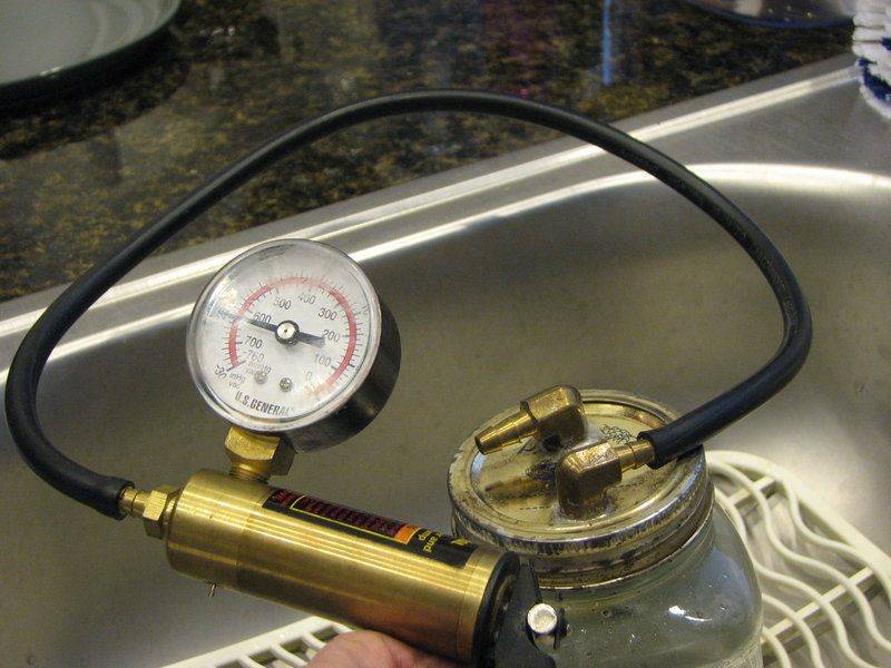

Here is proof-of-concept that a 1-½ quart canning jar is good for 25in Hg of vacuum. That's all my cheap vacuum pump was good for, in fact I had to mostly fill the jar with water to get the volume low enough for that vacuum. The little dome in the middle of the lid operates around 10in Hg. The second port on the jar has a vinyl dip tube which I doubled over and held crimped shut with a Binder Clip from the Stationery store.
As you can see, the experiment was done in the kitchen sink, with a heavy leather motorcycle jacket as a blast shield. Since it didn't blast, the jacket was removed and the photo snapped.
I would be a little concerned with using a rubber stopper in a wide mouth jar. It seems to me you would get a wedge effect of the stopper around the rim of the jar. Could the wedge effect be enough to but tension on the jar rather than compression?

Thanks for sharing, Tom. I'm not surprised you got it down to 25" and holding up as the Foodsaver and other pumps bring it down to 20.
I've decided that I'm going to place whatever jar is used inside of the plastic hermetic canisters I mentioned before. Poke a small hole in the side or top so the tubing will reach the mason jar, and go from there.
If I could ask, how do you have your ports in place... glued or soldered? I was thinking of that, but not sure how long the seals would hold for the 2-4 weeks it would be frozen. Thanks.

Soldered. The lid will flex in use, breaking any glued interface. Use a sharp knife and a wire brush to get down to bare metal. Then I used a propane torch (a large solder iron would work too) and Silver Solder to solder brass hose barbs into drilled holes. Tin both lid surfaces and the brass fittings before assembly, that way you need less heat on the lid. I don't recall for sure, but I may have had wet paper towels on the gasket to avoid destroying it. You want a solder fillet on both lid surfaces. Plan ahead. My first attempt had the brass fittings pointing away from each other; couldn't get the band on the lid. I haven't found any Silver Solder with flux in it so you will need some flux too. Clean all the flux off afterwards as most of it is corrosive and hygroscopic. A stiff toothbrush and ordinary rubbing alcohol works if you get to it as soon as it cools from soldering. If you don't have some experience soldering this way, perhaps you can find someone that does. You don't want any pinholes in the solder joints. The again, lids usually come in multi-packs so you can get lots of practice if you want to.
If the lid doesn't seal well enough for long-term storage, use vacuum grease (or maybe silicone grease) on the gasket.

If you don't need to see through it, ...
seems to me this type of product already handles vacuum...
not really cheap, though. Thrift shop perhaps?
