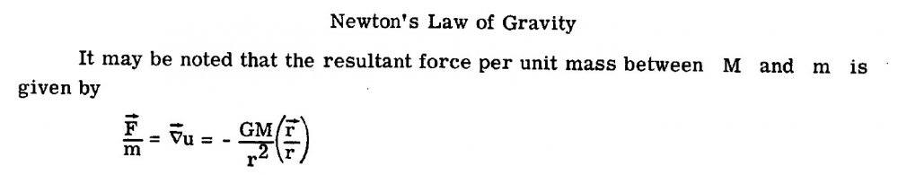

If we have a conservative vector field, then we can describe it as ##\textbf{F}=\nabla\phi## where ##\phi## is some potential.
This here is the derivation of Newtons law of gravity:
Where ##\nabla u## is the gravitational potential. If we were to ignore it as a gravitational field, why is it force per unit mass? Should it not be the same expression as an arbitrary conservative field?
Zack K said:
Summary:: I have gotten confused over two definitions of potential I have found. These two definitions of potential seem to argue different expressions.
This here is the derivation of Newtons law of gravity:View attachment 261776
The potential energy field is is in units of energy per unit mass. So the associated force field is in units of force per unit mass.
If the potential field were in units of energy per cherry pie then the associated force field would be units of force per cherry pie.
If the potential field were in units of energy per coulomb then the associated force field would be in units of force per coulomb.
If the potential field were in units of energy then the associated force field would be in units of force.
Nothing more exciting than that going on here.
Likes Zack K and Dale
##\mathbf{F} = - \nabla U##, if ##U## is potential energy
##\mathbf{g} = - \nabla \phi##, if ##\phi## is potential
@jbriggs444 basically said all there is to say. The gravitational field is the limit as the test mass mass ##m## goes to zero of ##\frac{1}{m}## times the gravitational force. The gravitational potential is the limit as the test mass ##m## goes to zero of ##\frac{1}{m}## times the gravitational potential energy. It's just a factor of ##m##.
N.B. I've put negative signs in because of the conventions with potential and potential energy but it's not strictly necessary to. You can have a perfectly valid force derived from a scalar field with no negative sign out the front.

I seem to have forgotten that g was associated with a vector field, thank you. So it is written as ##\textbf{F}=m\textbf{g}= -m\nabla u##.

I would not worry overmuch about it. Just realize that gravitational potential is most reasonably expressed in energy per unit mass. And electrostatic potential is most reasonably expressed in energy per unit charge.
Which is nothing more than realizing that a wagon with two tons of bricks at the top of a hill has twice as much potential energy as a wagon with only one ton of bricks. The potential [energy] of the field scales with your test mass.
[Edit courtesy of @hutchphd]
If you have potential in standard units and you want potential energy, multiply by the size of your test mass.
If you have the potential energy of your test mass and you want potential in standard units, divide by the size of your test mass.
