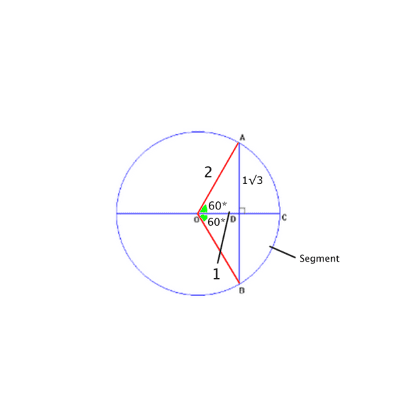

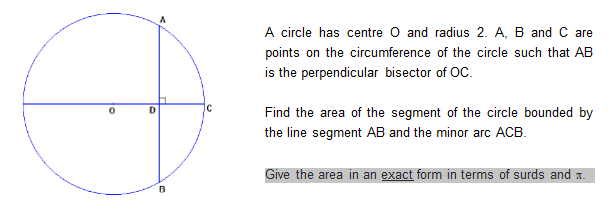

Find the circle segment area that has the boundaries of line segment AB and the minor arc ACB.
Give the area in an exact form in terms of surds and Pi. (see attachments for annotated picture & original question).
Equation 1: Area of a segment = Sector area - Triangle area
Equation 2: Sector area = Central angle/360 * pi * diameter
Equation 3: Triangle area = 0.5 * base * height
Area of sector = 120/360 * pi * 4
Simplified = 1/3 * pi/1 * 4/1 = 4/3 * pi [Units squared]
Area of one of the triangle = 0.5 * 1√3 * 1
Combined triangle area = 0.5 √3 x 2 = 1√3
Segment area = (4 * pi/3 - √3) [Units squared]
Approximated answer = 2.4567

Hi Matt. I see you are new here ... http://imageshack.com/a/img515/4884/welcomesign.gif
Your answer is right. Your working is very well presented.
I would not include the real approximation, since it's the exact form that is required.
Can you see a way to check your answer yourself?

Hello Nascent Oxygen,
Thank you for your feedback, I appreciate it.
The only methods I can think to check if the answer is correct is to use one of the following equations. I know those equation give the same approximate answers. However I'm not sure if that is a reliable method of checking if the answer is correct.

I did have in mind just reversing the process to arrive at the area of the full sector, as a check of your arithmetic.
But, you're right, you could compare your answer with a published formula, as you quoted.
http://d2gbom735ivs5c.cloudfront.net/m/geometry/images/circle-segment-area.gif
Just to check I understand correctly. I would calculate the approximate area of the segment area and the approximate area of the triangle and add them together.
Segment area (2.4567) + Triangle area (1.7320) = Sector area (4.1887)
4 * pi / 3 + √3 = 120/360 * pi * r [squared]
