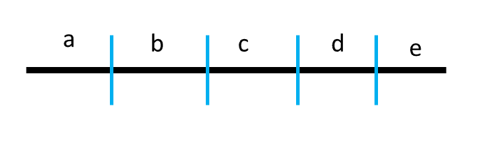

I know its quite late to revive the thread but I have come across a nice method (which doesn't use recursions) to solve the problem of linear arrangement and I am thinking if the same could be extended to the circular arrangement.
Consider the attachment 1. Let's select 4 things out of ##n##. I denote them with a blue line.
Let ##a,b,c,d## and ##e## denote the number of things between the selected ones. Then we have the condition, ##a,e\geq 0## and ##b,c,d\geq 1##. Also:
$$a+b+c+d+e=n-4$$
Number of solutions to the above equation with the given constraints are ##{n-3 \choose 4}## which is our answer to the linear arrangement.

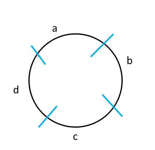

How do I extend this method to the circular arrangement?
If I follow the same procedure as above (attachment 2), I have the condition ##a,b,c,d\geq 1## and
$$a+b+c+d=n-4$$
The solutions to the above are ##{n-5 \choose 3}## and this is definitely incorrect.
I am thinking of following DH's advice in #2 but I am not sure how to implement it. :(
$$a+b+c+d+e=n-4$$
$$a+b+c+d=n-4$$
This is essentially the same as my method, and you can convert the problem from a circle to a line the way you do above. But first, you have to remember that you are making the first choice, the one that breaks the circle, special. So you have to think of it as an ordered selection of four. Correspondingly, having broken it out into a line, you are making an ordered selection of three. So the number of ways is ##\frac{(n-5)!}{(n-8)!}##. Since you had n ways for the first choice, that's ##\frac{n(n-5)!}{(n-8)!}## for the ordered choice of four. Finally, to convert it to an unordered choice, divide by 4!, giving the desired answer.

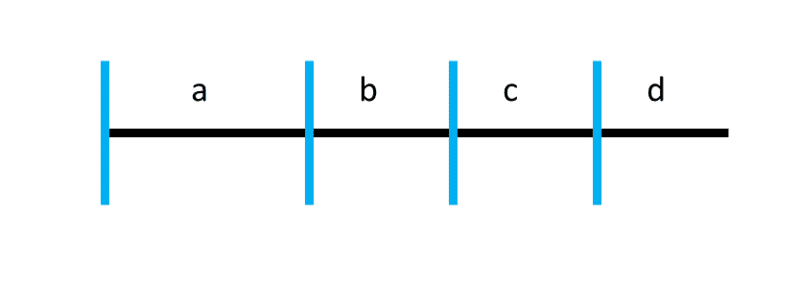

I am not getting why you are considering the ordered selections.
If I break the circular arrangement at some point, then I have a situation as shown in the attachment.
$$a+b+c+d=n-4$$
With the constraint ##a,b,c,d\geq 1##, the solutions to the above equation are ##\dfrac{(n-5)!}{(n-8)!3!}##. :confused:
You broke the circle by making your first selection (n ways). You then obtained a formula for making three unordered selections from what remains. But this is not the same as making four unordered selections. Your first selection is special.
One way to resolve that is to ask how many ways you can make an ordered selection of four from the n. So now you make the first selection, and an ordered selection of the remaining three. This gives the right answer for four ordered selections. Finally, divide by 4! for four unordered.
Yes, I understand the first selection is special and there n ways for the first selection.
I can find the ordered selection of four from n but I don't see why should I be doing that here. Can you please give an example to show why the unordered selection fails? :confused:
If I continue with what I wrote above, I have to simply multiply by ##n## and divide by 4. Multiplying by ##n## makes sense because the first selection is special but I can't see why I need to divide by 4. :(
Your procedure picked one from n, then 3 from n-1. This makes picking A, say, then {B, C, D} different from picking B then {A, C, D}. So you have effectively counted every valid selection {A, B, C, D} four times.
Very nicely explained, thanks haruspex! I finally understand this now. :smile:
