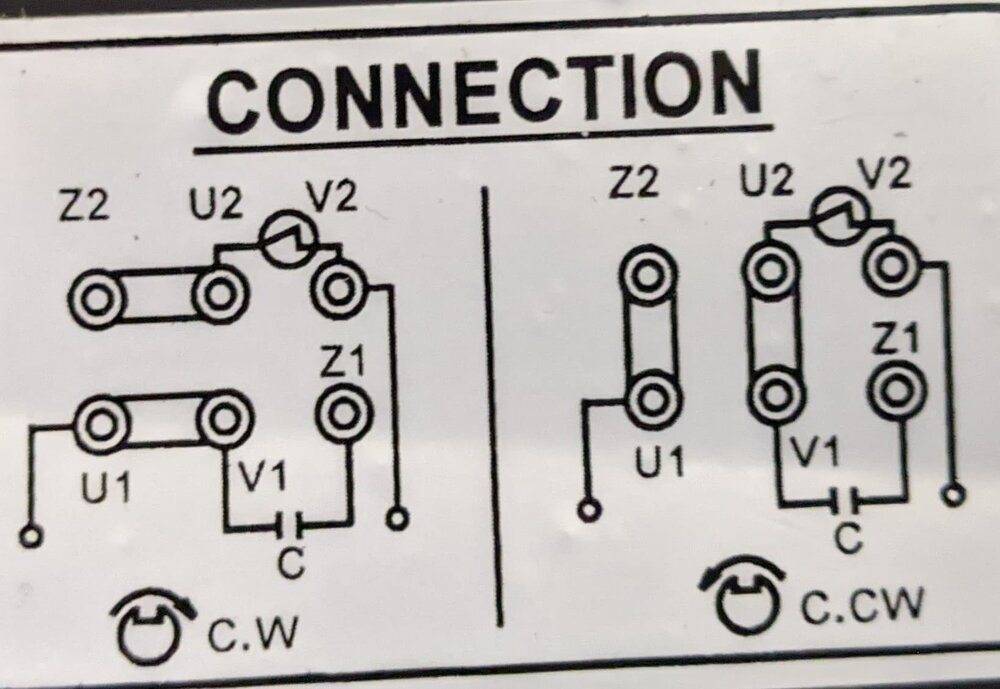

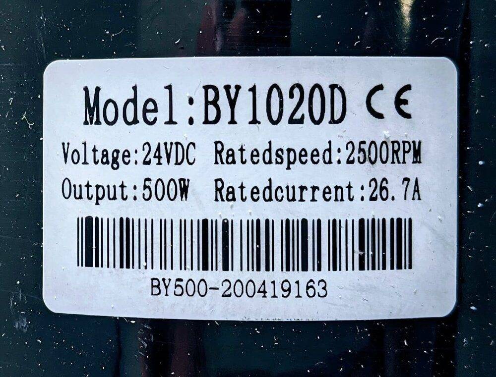

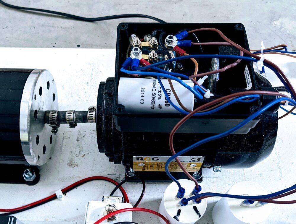

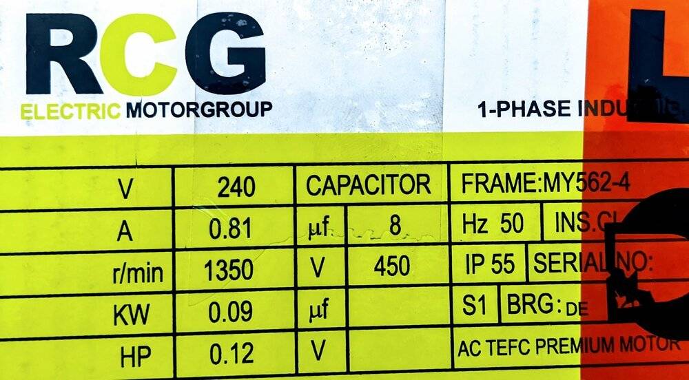

Hi I'm doing a uni project and need help with a Self Excited AC Single Phase Generator. I'm using an AC Single Phase Induction Motor to act as the generator. Its turned by a DC Motor
The AC motor is 1350 RPM and the DC motor is 2500 RPM
Its not producing any electricity (just a few volts) for some reason. I think I have the capacitors wired incorrectly
I have 2 x 20 mF capacitors connected to the power terminals and the generator turns CW clockwise
The AC motor has 6 terminals
2 for power, 2 for an existing 8 mF capacitor and another 2
See attachments
Any suggestions? Thanks

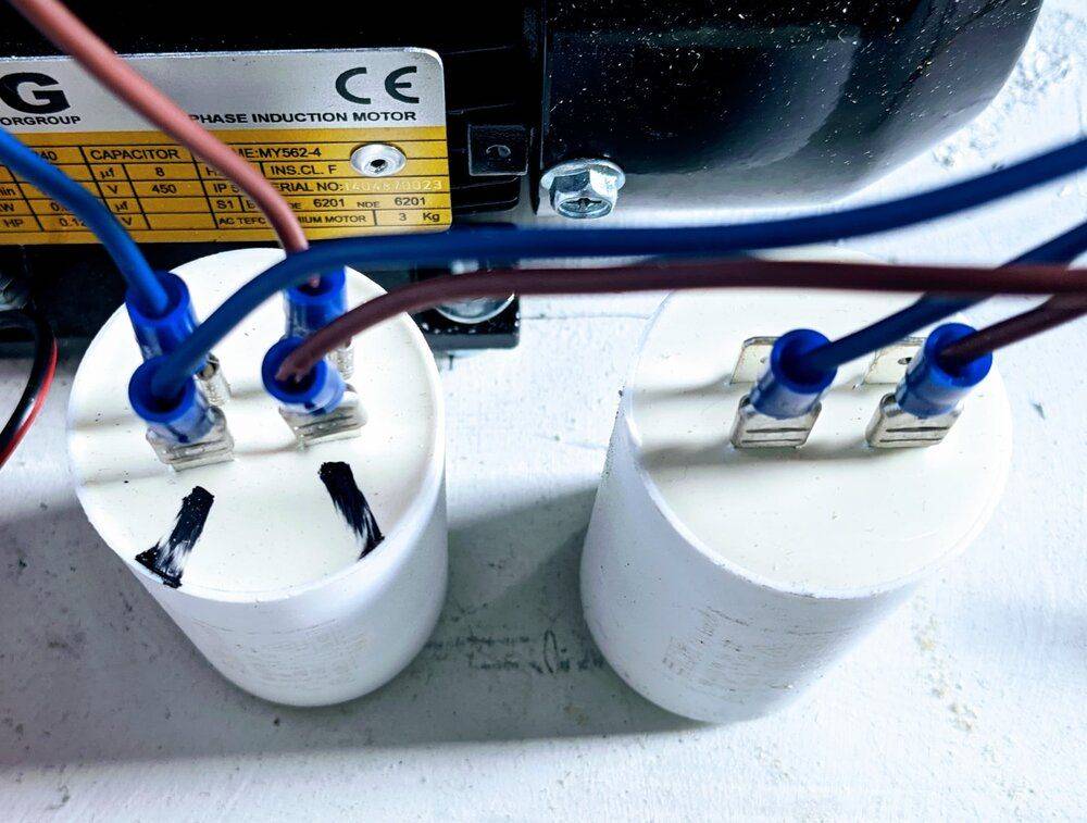

I'm not sure abut the locked rotor. In YouTube videos on it, one guy just adds capacitors until it works and the other guys uses three 20mF capacitors in a delta configuration
I'm also not sure if I have the capacitors wired correctly and if they should go directly to the two power terminals on the AC motor or any of the other terminals? See image

BuckBee said:
I have a rectifier to convert to DC then a buck converter to drop the voltage down to a consistent 48V
You misunderstand the situation. AC motors are inductive. Parallel capacitor(s) are used to compensate the Power Factor, PF, of an AC motor, to get the phase of the current close to the phase of the applied voltage.
If an induction motor is overcompensated for PF, by adding too much capacitance, it becomes an induction generator when the AC supply is disconnected. Motor momentum and the LC resonance, can produce a damaging over-voltage.
Without any load, and at an RPM just a few % above LC resonance, the AC voltage generated may rise to the point where it can damage the induction generator and the capacitor insulation.

The delta configuration is used with a three phase motor. That is the easiest to work with because the three windings at 120° on the motor are all the same.
With a single phase motor there is a main winding, and a starting winding at 90° that is normally driven through a series capacitor. The combination of the two fields makes a directional rotating magnetic field that drags the armature around in the required direction while starting.
As a motor you would use a parallel run capacitor to adjust the power factor.
You will use a series starter capacitor on the other winding to start it spinning in the required direction.
As a generator you will use parallel capacitors to set the synchronous speed in RPM.
If you load an induction generator while starting, it may overdamp and so prevent the resonance needed to excite the generator.
If you overload an induction generator while it is operating, you will draw away the excitation energy, kill the field, so it will stop generating.
The ideal induction generator is operated a few percent above synchrous while connected to and excited by the three phase grid. Self excited induction generators are more precarious and need to be carefully managed.

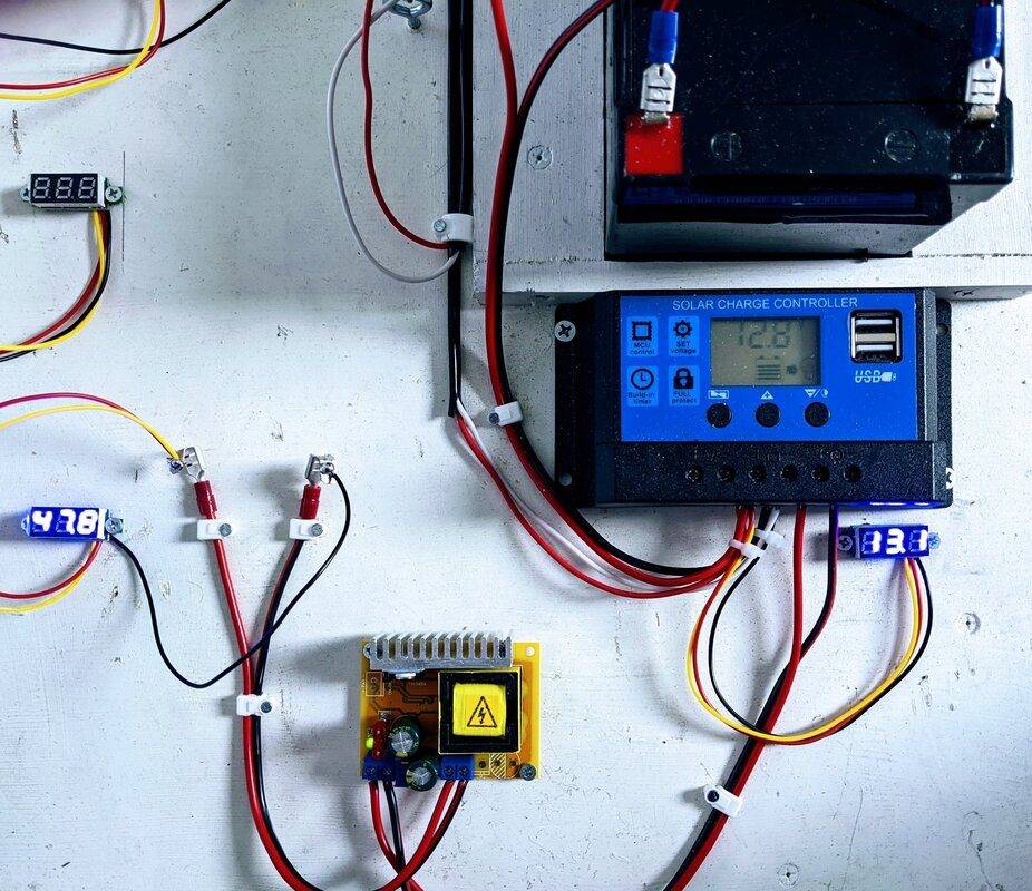

What are you really trying to do ?
Are you inverting low-voltage DC to produce AC ?
There is probably an easier way than a single phase self excited induction generator.
What will you do with the AC once it is generated ?
Hi, You are trying to use an AC induction motor as a generator?Well, maybe my knowledge of electric motors may be outdated by now but I have NEVER heard of an AC single phase motor being able to be used as a "generator". Firstly the term "generator" as I know it refers to a machine designed to "generate" a DC output.
They are generally built with field coils to generate a magnetic field and have an "armature" which is wound with wire coils and connected to a commutator. The armature is rotated by some power source(turbine, diesel etc) and the rotation of the armature in the magnetic field generates a voltage which is collected by sets of brushes at the commutator.
A machine which outputs AC is called an ALTERNATOR( to my knowledge). Very similar except the rotating part is called a "rotor" and is wound with a coil connected to sliprings which are connected to a DC source to provide a rotating magnetic field. The magnetic field couples to coils wound in the "STATOR" and the rotors magnetic field generates a voltage in the stator coils which is the output.
An AC Induction motor does not have any wound coils in the rotor but depending on type has a "squirrel cage" of bars (usually aluminium) imbedded in rotor laminations. The coils of the stator windings generate a moving magnetic field which connect to the rotor and "induce" a voltage and current(basically act as a transformer). This induced magnetic field reacts to provide the torque reaction to spin the motor shaft and do work.
Now from what I read of your question I cannot see how you can generate ANY useful output since there is no rotating magnetic field or wound "rotor" in your machine. Any voltage you are seeing(at the U1, U2 terminals I presume) is only from a slight residual magnetic field left in the rotor generating a slight voltage at the motor terminals as you spin the rotor.
Looking at your pic of the motor terminals,it looks like a straight forward AC single phase motor with two field stator windings. Two windings are required to provide a "rotating " field. One winding is connected directly to the ac power supply and the other winding has the 8Mfd capacitor in series. The makes two AC fields at a "phase angle" to each other and appears as a "rotating field" to spin the rotor. Not quite sure about the device V2. It could be a start switch which disconnects the capacitor field winding once up to speed. The different connections shown are the way to change motor rotation by changing the links.
Not sure what all the talk about synchronous speed is. Synchronous speed refers to the speed required to bring parallel connected ALTERNATORS to the SAME speed and PHASE angle to allow connection to the grid.
I very much doubt you will get ANY useful output trying to use this setup. If you want to generate any useful AC I suggest driving a car alternator which will give you three phase output at about 15 volts and 40 plus amps(depends on alternator and drive unit). Actually looking at the power ratings you would be better off using the AC motor to drive the DC motor as a generator. So you want to rectify the AC and then convert it to stable DC? By using a dc motor to drive an AC motor? see previous sentence. Love to see how you get on.

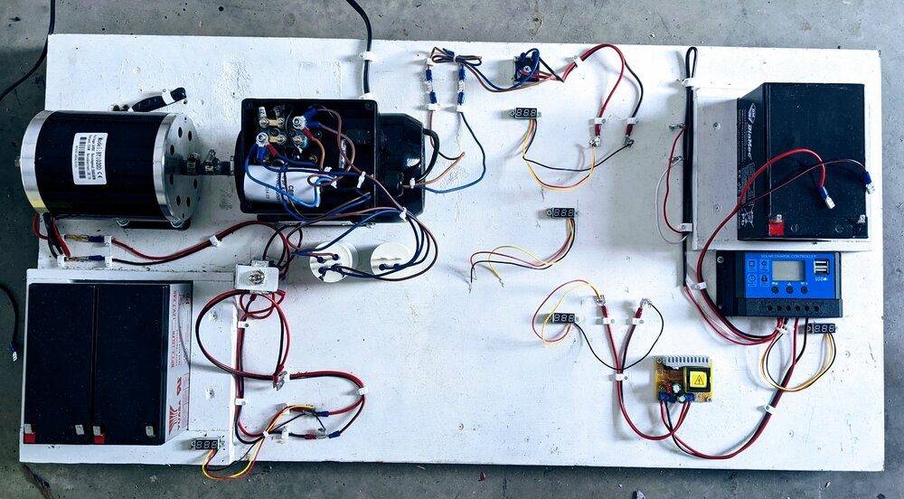

Hi the project is a wind farm simulation with 48v DC micro grid. The DC motor simulates the wind fan, the AC motor acts as the generator to produce about 100v AC. Its then rectified to DC and bucked down to 48v. The 12v DC battery is boosted up to 48v DC to provide power when there is no wind. The aim is to produce a constant 48v DC. Image attached
