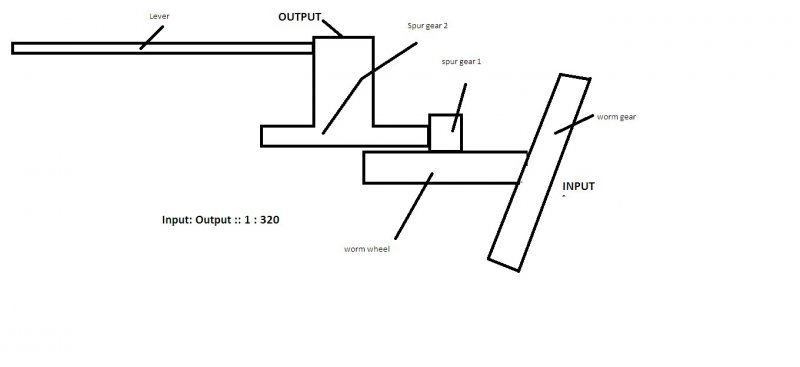

Hi
I have built a gear drive for robotic arm that uses a worm set (worm gear +worm) at stage one. Worm (wheel) is of bronze and worm gear is steel haing a lead angle of appx 8 deg. This set is further coupled to a spur gear set that further increases the torque such that the over all gear ratio is 1: 320. Now ideally the gear drive can be rotated from the output shaft as the lead angle is greater than 4 deg. However for some reason this mechanism is exhibitoing self locking in a way that even applying 40 kgs of load at the output shaft, the input does not rotate. can anyone explain this? The literature suggests these lead angles should not indicate self locking.

Thanks a lot for replying. Please have a look at the image. The load (40 kg) is applied at the end of the lever which is 300 mm in length but the input worm gear does not rotate even then. The theory suggests that the back drive is more linked to the lead angle and as such not related to the torque. For my design, I want this self locking feature but i don't know at the moment why its exhibiting this self locking when lead angle is on higher side, so want to be sure. for lubrication i am using grease and the gear materials are bronze for worm and Stainless steel for worm gear and spur gears.

Your worm appears to be at 90 degrees to the plane of the worm wheel. Where is the axis of the worm ?
This makes the 8° lead angle specification confusing. Are you sure your angle is not (90° - 8°) = 82°

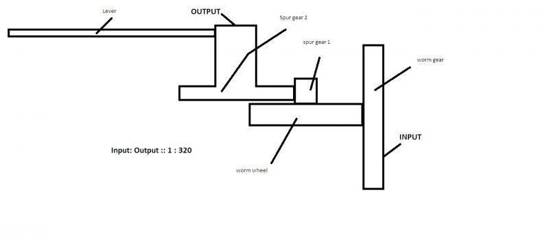

Apologise for not correctly indicating the worm mesh. Both planes are parallel (worm and worm gear) as they should be, which means that the axis of the wheel is perpendicular to the axxis of the worm gear. I tried to resketch the case.

So, when you rotate the worm, the 8° lead angle advances the worm wheel by one tooth per turn of the worm.
But when you turn the wheel it is driving the worm with an 82° contact angle. That is why it locks.

I assume there is no motor connected to the worm for your tests. The worm must therefore have end thrust bearings. When the wheel drives the worm there is maximum thrust on those bearings so also maximum friction.
