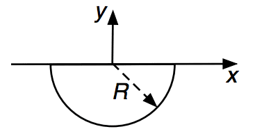

A semi-circle of radius R has a charge Q uniformly distributed over its length, which provides a line charge density λ. Determine E at the origin.
https://www.physicsforums.com/attachments/105239
I can tell by argument of symmetry that the Electric field will be pointing in +y direction.
If we take a sliver of the charge, call it dq, we will calculate the Electric field.
[tex] E = \left(\frac{1}{4πε_0}\right)\left(\frac{dq}{R^2}\right)sin(θ) [/tex]
Also: [tex] \left(\frac{dq}{dθ}\right) = \left(\frac{Q}{π}\right) [/tex]
so: [tex] dq = \left(\frac{Qdθ}{π}\right) [/tex]
Now:
[tex] E = \left(\frac{1}{4πε_0}\right)\left(\frac{Qsin(θ)}{πR^2}\right)dθ [/tex]
After calculating the integral from θ = 0 to θ = π I get the following answer:[tex] E = \left(\frac{1}{2πε_0}\right)\left(\frac{Q}{πR^2}\right)\hat{y} [/tex]
Does this work appear to be correct? I want to make sure I get this easy material down before I go to the more difficult material in electromagnetism. If so, is it fair to say that the linear charge density typically symbolized as λ is equal to Q/π in this problem. Q is the charge in coulombs and pi is the length of the semicircle. So I could represent my answer as:
[tex] E = \left(\frac{1}{2πε_0}\right)\left(\frac{λ}{R^2}\right)\hat{y} [/tex]

I cannot open the file.
Regardless of the missing picture, your final answer is correct.
No, that cannot be a linear charge density since its dimension is the same as that of the charge. Note that the circumference of a semicircle must contain its radius.

The radius is not 1, is it?
The charge is spread over the semicircle. What is 1/2 the circumference of a circle of radius, R ?
Also, missing from the problem statement is the location and orientation of the semi-circle. (I could not access the image.)

Hey guys,
Sorry about the image not showing -- it was an accidental double post.
I see your point on the radius. I watched a video on this problem and did not take into consideration that the radius of that video = 1, while my radius = R. So the Linear charge density would be Q/(pi*R), is this now correct?
Due to this fact, I will have to change my answer slightly to:
[tex]E = \left(\frac{1}{2πε_0}\right)\left(\frac{Q}{πR^3}\right)\hat{y}[/tex]
It's now correct.
E=(12πε0)(QπR3)^yE=(12πε0)(QπR3)y^​
Why would there be an extra ##R##? Your previous answer (2nd equation from the last in post#1) is already correct.
Likes RJLiberator and SammyS
If linear charge density
[tex] λ = \left(\frac{Q}{πR}\right) [/tex]
Then the final answer :
[tex]E = \left(\frac{1}{2πε_0}\right)\left(\frac{Q}{πR^2}\right)\hat{y} [/tex]
which is:
[tex]E = \left(\frac{1}{2πε_0}\right)\left(\frac{λ}{R}\right)\hat{y} [/tex]
Thank you for the help.
