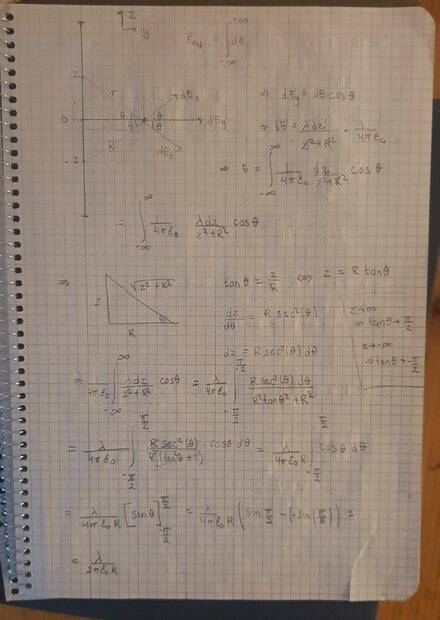

Determine the amount of the force per unit length acting on the line charge from a semi-circular cylinder with a radius R. The axis of the cylinder is perpendicular to
the plan of the figure. The cylinder is very ("infinitely") long and has a surface charge density σ. Theris a line charge with longitudinal charge density, λ_0, at the center.
##E = \frac{1}{4\pi \epsilon_0} \int \frac{dq}{r^2} ##
## F = qE##
Hi!

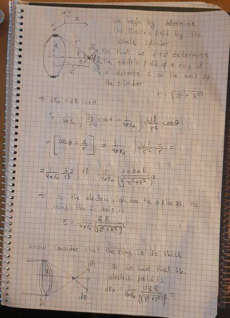

I think I solved the problem but I would like you to take a look at it please, is it right? is there a better way to solve it?

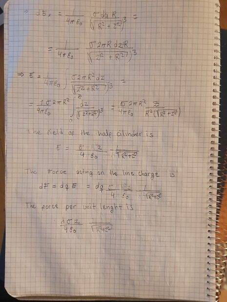

I am not sure where you go wrong but I think your final answer shouldn't depend on z, because the problem has z-symmetry.
There is a much easier (I believe) way of solving this. Calculate the force that the line charge (of the center) applies to the infinite half cylinder and then use Newton's 3rd law to equate this force with the force requested by the problem's statement.
BTW, when you integrate, you set the limits of integration from 0 to z, I think they should be ##-\infty## to ##+\infty##.

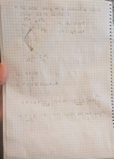

I followed your advice and I got that the electric field due to a charge line at a distance R is $$ E = \frac{\lambda}{2 \pi \epsilon_0 R} $$ ( I'm searching the magnitude of the force per unit charge not the dircetion)
And that the Force per unit length is $$ \frac{F}{L} = \frac{\sigma\lambda R}{\pi\epsilon_0 L}$$
is that right? I maybe can write the force per unit length as
$$ \frac{F}{L} = \frac{\sigma Q R}{\pi\epsilon_0} $$ where Q is the charge of the rod
I realized that I have to use ##\lambda## so forget the expression with Q

This seems to have got a bit confused. In any case, there shouldn't be an ##R## in the answer. I think your first answer was closer, as you had the correct integrand.
https://www.physicsforums.com/threads/electric-field-due-to-half-cylinder.718319/

The factors of ##R## should have canceled in the integration: you have ##\frac 1 R## in the electric field and ##\sigma Rd\theta## in the surface charge of the cylinder.

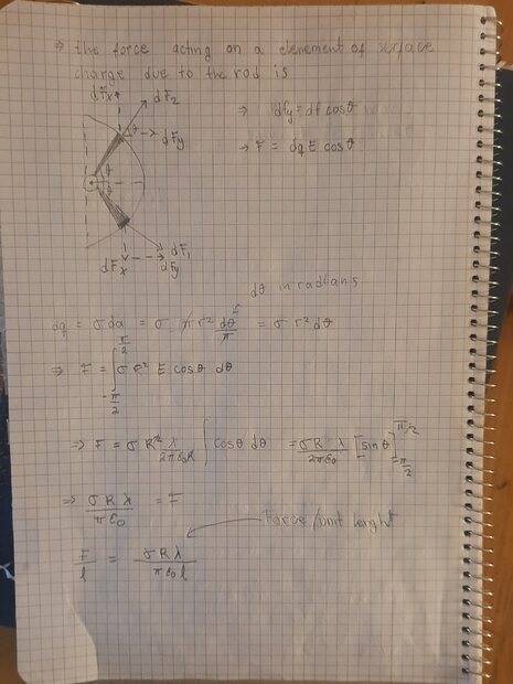

ahh, I see I was unsure how to write #dq# due to the cylinder, ##dq = R \sigma d\theta##?
which method do yo think I should use?
Yes, that's the infinitesimal charge on a strip of the cylinder of unit length.

so I changed dq in the integral, is my calclation correct? I mean that F is the force per unit length right?
If that says ##\frac{\lambda \sigma}{\pi \epsilon_0}## then yes.
It does, Thank you everyone 😊 😊
