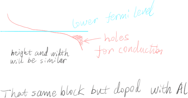

the numbers about si or si-Al were made-up, they were examples to explain "high" (closer to 0 potential) and "wide" (how wide is the valence band, in eV). what does this have anything to do with T = 0? at T=0 fermi level falls exactly on the top edge of valence band, and there is no more "50% distribution" about fermi level. every state above fermi energy have 0 chance of seeing an electron, every state below fermi energy have 100% of seeing an electron.
I don't know exact values of fermi energy of a particular mix of Si and Al @ T=0, I don't know what energy is needed to excite electron to free itself from the yoke or Atoms and Lattice. Have not gotten that far yet. But one thing I am certain, a voltage source may not be strong enough to excite electrons to move, a CURRENT source will cause electrons to flow thru.

My original post was saying the below:
You have a severe misunderstanding here. The Fermi level doesn't change with temperature! It is defined at T=0, and it is NOT exactly at the top edge of the valence band at T=0! For an intrinsic semiconductor, it is ALWAYS in the middle of the gap! For an extrinsic semiconductor, it depends on the density of the dopant!
Other than that, I have no idea what you had written in the rest of your post. I suggest you look at the FULL band structure of Al-doped Si!
Zz.
Thank you for staying with me, I appreciate your patience. My English is not that good. My motive is not solving academic problems, thus my questions are very odd as well. So thank you.
Now, Fermi level and Fermi energy are two different concepts. Fermi level does vary with temperature, it is the hypothetical 50% level electron fill level. I think your "Fermi level" is referring to "Fermi energy", which is the "T=0, filling up all states and see at what level we end up with" level.
I don't think anyone will re-read any of my post, so could you just comment on the picture with blue and red I posted. in one sentence, "P-type can conduct, because the fermi level (50% chance electrons can fill that level) is very close to the valance band" Or "P-type doesn't have enough electrons to fill up the valance band".
I think you started with a misconception, a band structure is an energy structure, it represents possible energy levels(each having no. Of possible quantum states) that can be occupied by particles(say electrons), these are formed when wave functions representing neighbouring interacting particles are overlapped.
So, you can safely say that the valance band structure of an intrinsic Si and Al doped Si will be different.
And the explanation that you want to counter i.e. "have vacant acceptor levels at energy Ea above the valence band. Electrons from the top of the valence band can be easily excited into these levels." is absolutely correct.
Well try to think like this, an Al atom has 3 valance electrons and Si has 4, which means there will be an unoccupied hole(since Si needs 4 bonds). The energy state Ea is called the acceptor energy state representing an energy level of these empty positions(acceptor holes), at Ea the quantum states are supposedly to be empty at T=0 (freeze out effect). As Temperature increases the thermal energy is utilized by some of the electrons in the valance band and they get excited to acceptor energy state. Which makes aluminium atoms -ve charges and produces a holes in the valance band, such valance band holes constitutes hole current.
I hope it helps you.
