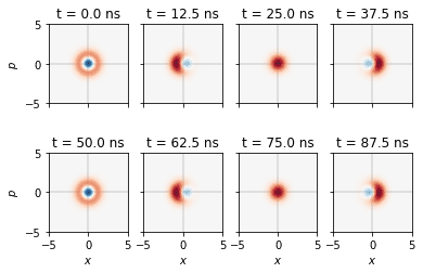

Wigner Function
The Wigner function allows us to see a representation of the state of the cavity in phase space.
We can use the Wigner function to generate probability distributions: the probability distribution of finding the cavity at position ##x## is
$$\left|\psi(x)\right|^2 = \int_{-\infty}^{+\infty} W\left(x,p\right)\mathrm{d}p$$
and similarly at momentum ##p##
$$\left|\psi(p)\right|^2 = \int_{-\infty}^{+\infty} W\left(x,p\right)\mathrm{x}p$$
By looking at the Wigner function, we expect to see the Gaussian blob to start at (0, 0), and spiral outwards towards larger amplitudes while rotating around the origin. Below we plot the Wigner function every 20th timestep, *i.e.* with a rate equal to the drive frequency. Thus, we don't see the spiralling but only the Gaussian moving towards larger values of ##x## monotonically.
Code:
fig2, ax2 = plt.subplots(2, 4, sharex=True, sharey=True)
ax2 = ax2.flatten()
xvec = np.linspace(-5, 5, 200)
for axi, idx in enumerate(range(0, ns // 2, ns // 16)):
    rho = output.states[idx]
    W = qt.wigner(rho, xvec, xvec)
    wlim = np.abs(W).max()
    ax2[axi].imshow(
        W, cmap='RdBu_r', vmin=-wlim, vmax=wlim, origin="lower",
        extent=(xvec.min(), xvec.max(), xvec.min(), xvec.max()),
    ax2[axi].axhline(0.0, c="tab:gray", alpha=0.25)
    ax2[axi].axvline(0.0, c="tab:gray", alpha=0.25)
    ax2[axi].set_title(f"t = {tlist[idx]} ns")
[ax2[axi].set_xlabel(r"$x$") for axi in [4, 5, 6, 7]]
[ax2[axi].set_ylabel(r"$p$") for axi in [0, 4]]

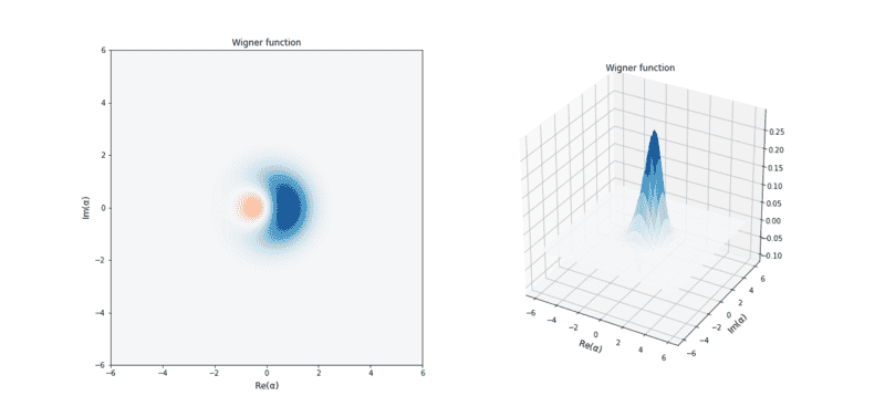

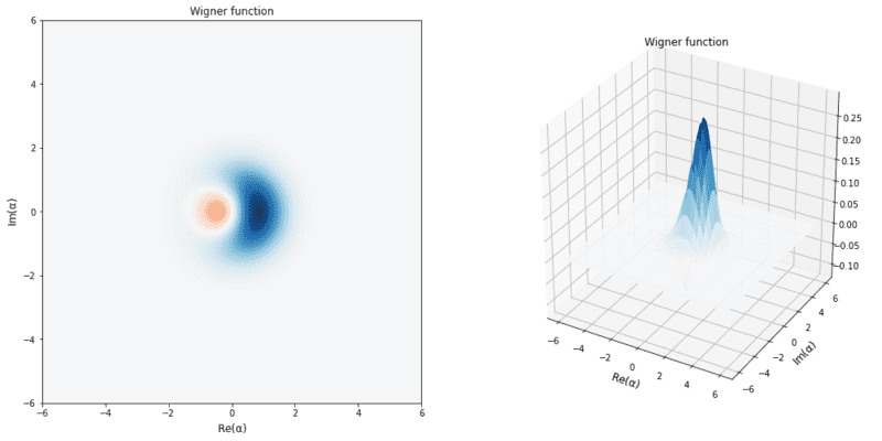

Plot in 3d to see how the states looks like, which is exactly the same as the demo one. So I believe I transform it correctly to the superposition state.
Code:
psi2 = rho
plot_wigner_2d_3d(psi2)
That's great! I got the state I expected from the demo. However, I got stuck afterwards.

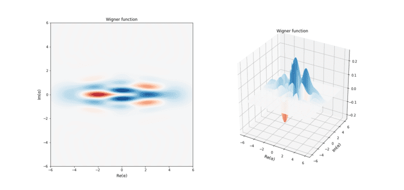

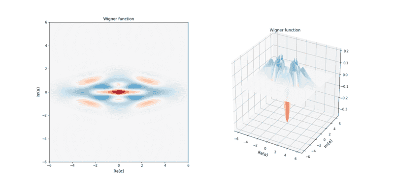

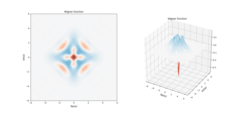

Step 4 - From Superposition to the cavity in a coherent state by applying a drive pulse (it is where I stopped)
$$\vert \Psi \rangle = \frac{1}{\sqrt{2}} [ \vert 2\alpha \rangle \otimes \vert g \rangle + \vert 0 \rangle \otimes \vert e \rangle] $$
I expect the state looks like
I know I need to apply a drive tone to the cavity at frequency ##\omega_c##, to displace the cavity state from ##\vert 0 \rangle## to ##\vert \alpha \rangle##. if and only if the qubit is in the ground state. If the qubit is in the excited state, the cavity remains in the vacuum state.
But I do not know how to apply the drive pulse to state, as they are in tensor product. How can the drive pulse only act on the cavity but not the qubit?
I hope someone can shed some light here.

I state all the things once more for clarity
Code:
# Parameters
N = 30  # Hilbert-space cutoff, ideally infinite, but infinite is big
wc = 2 * np.pi * 6.0  # cavity frequency, Grad/s
wq = 2 * np.pi * 5.0  # qubit frequency, same as cavity
# Initial state: cavity in ground state with qubit in syperposition
psi2
#Add dissipation
kappa = 2 * np.pi * 0.001  # cavity linewidth, Grad/s (rate of photon loss)
gamma = 2 * np.pi * 0.005  # qubit linewidth, Grad/s (rate of photon loss)
g = 2 * np.pi * 0.10  # strong coupling strength, Grad/s
delta = abs(wq - wc)  # detuning, GHz
chi = g**2 / delta  # dispersive shift, GHz
T0 = round(abs(2 * np.pi / chi))
USE_RWA = True
# Cavity operators
a = qt.tensor(qt.destroy(N), qt.qeye(2))  # annihilation
n = a.dag() * a  # photon number
x = qt.tensor(qt.position(N), qt.qeye(2))  # x = 1/sqrt(2) * (a + a.dag())
p = qt.tensor(qt.momentum(N), qt.qeye(2))  # p = -1j/sqrt(2) * (a - a.dag())
# with these definitions: <x>^2 / 2 + <p>^2 / 2 = <n>
# Qubit operators (Pauli matrices)
sx = qt.tensor(qt.qeye(N), qt.sigmax())  # sp + sm
sy = qt.tensor(qt.qeye(N), qt.sigmay())  # 1j * (sm - sp)
sz = qt.tensor(qt.qeye(N), qt.sigmaz())
sp = qt.tensor(qt.qeye(N), qt.sigmap())  # (sx + 1j * sy) / 2 == sm.dag()
sm = qt.tensor(qt.qeye(N), qt.sigmam())  # (sx - 1j * sy) / 2 == sp.dag()
# identity matrix
eye = qt.tensor(qt.qeye(N), qt.qeye(2))
#collapse operator
c_ops = [
    np.sqrt(kappa) * a,
    np.sqrt(gamma) * sm,
# Time array
fs = 120.0  # sampling frequency, GHz
dt = 1 / fs
T = 2 * T0  # time, ns
ns = int(round(fs * T))  # nr of samples
tlist = dt * np.arange(ns)  # nanoseconds
# Drive
#wd = wq  # drive at the qubit transition frequency
#amp = np.pi
#phase = -np.pi / 2
#if USE_RWA:
#    drive = amp * np.exp(1j * (wd * tlist + phase))
#else:
#    drive = amp * np.cos(wd * tlist + phase)# Drive
wd = wc  # drive at resonance
amp = 10.0
phase = -np.pi / 2
if USE_RWA:
else:
# Cavity drive
#wd_c = wc - chi  # drive at the frequency corresponding to ground state
#amp_c = 0.04
#phase_c = np.pi / 2
#drive_c = amp_c * np.sin(np.pi / T * tlist)**2 * np.exp(1j * (wd_c * tlist + phase_c))
# Hamiltonian
H0 = wc * (a.dag() * a + eye / 2) + 0.5 * wq * sz
V = chi * (a.dag() * a + eye / 2) * sz  # dispersive interaction
H = [
    H0,
    V,
    #[a * sp, g * np.exp(1j * delta * tlist)],
    #[a.dag() * sm, g * np.exp(-1j * delta * tlist)],
    [a, 0.5 * drive],
    [a.dag(), 0.5 * drive.conj()],
#H = [
#    H0,
#    V,
#    [a, 0.5 * drive],
#    [a.dag(), 0.5 * drive.conj()],
#]output = qt.sesolve(H, psi2, tlist)

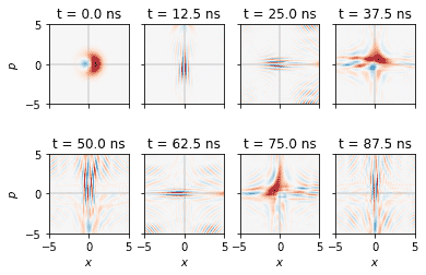

ax2 = ax2.flatten()
    ax2[axi].imshow(
psi3 = rho
plot_wigner_2d_3d(psi3)

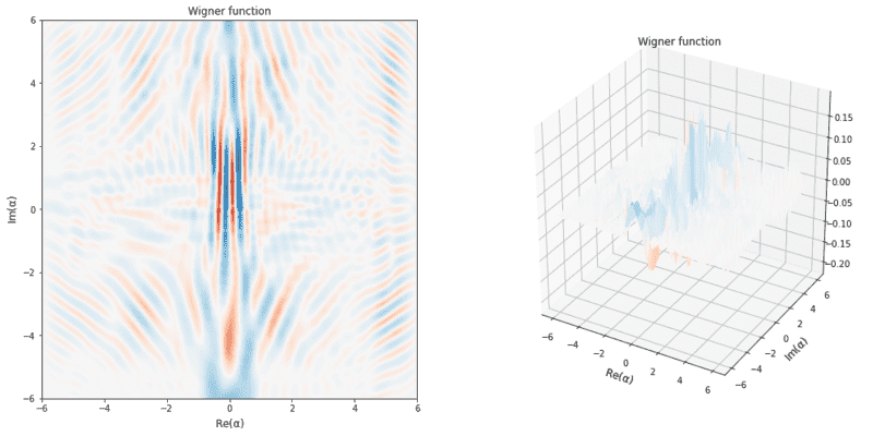

Here is the state I got for my step 4. It is not what I expected. I hope someone can correct my working.
