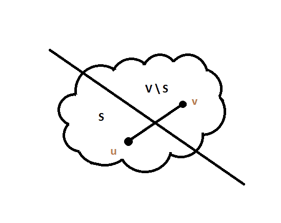

What is that: $(S, V \setminus S)$ any intersection of $G$,that respects $A$? :confused:
The edge $(u,v) \in E$ crosses the intersection $(S, V \setminus S)$, if one of its vertices is in $S$ and the other one in $V \setminus S$.
An intersection $(S, V \setminus S)$ respects a set of edges, if no edge of the set crosses the intersection.
