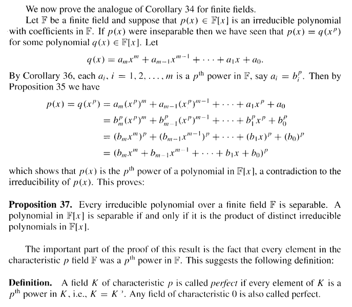

I am trying to understand the proof of Proposition 37 in Section 13.5 Separable and Inseparable Extensions ...The Proposition 37 and its proof (note that the proof comes before the statement of the Proposition) read as follows:
In the above text by D&F we read the following:

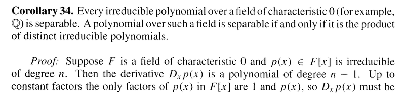

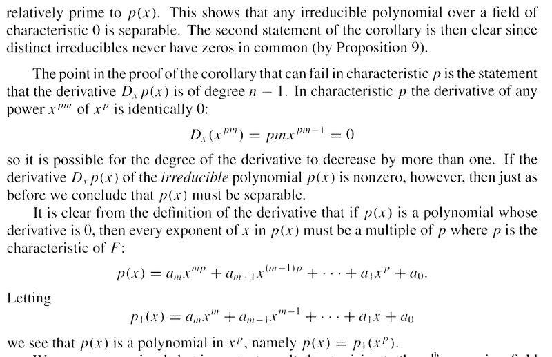

"If ##p(x)## were inseparable then we have seen that ##p(x) = q(x^p)## for some polynomial ##q(x) \in \mathbb{F} [x]##. ... ... "I cannot understand exactly why this is true ...Can someone please explain exactly why, as D&F assert, the following is true ... ...##p(x)## inseparable ## \ \ \Longrightarrow \ \ p(x) = q(x^p)## for some polynomial ##q(x) \in \mathbb{F} [x]##I cannot find where D&F establish exactly this implication ... but maybe there is some idea in the proof of Corollary 34 which reads as follows:

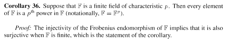

Corollary 36 may also be relevant ... so I am providing that as well ... as follows:

Call the irreducible polynomial ##P##, to distinguish it from ##p##, the characteristic of ##F##.
Since ##P## is irreducible, it must either be co-prime with ##D_xP##, or else ##D_xP\equiv 0##
If co-prime then by Proposition 9 (quoted in the proof of Corollary 34), ##P## has no roots in common with any of the irreducible factors of ##D_xP##. Hence ##P## has no roots in common with ##D_xP##. Hence ##P## is separable.
So if ##P## is not separable, we must have ##D_xP\equiv 0##, which means that for each natural number ##k##, the ##k##th order coefficient in ##D_xP## must be zero. That coefficient is ##a_{k+1}(k+1)## where ##a_{k+1}## is the ##k##th order coefficient in ##P##. Since ##F## is a field there are no zero divisors, so either ##a_{k+1}=0_F## or ##(k+1)_F=0_F##. I have put subscripts into make clear we are operating in ##F##.
So for every term ##a_rx^r## of ##P## we must either have ##a_r=0## or else ##r=0\mod p##, in other words ##r=ps_r## for some natural number ##s_r##.
But then each nonzero term of ##P## will be of the form ##a_{ps_r}x^{ps_r}## which can be written ##a_{ps_r}(x^p)^s_r##. So ##P## is a finite linear combination of powers of ##x^p##, ie a polynomial in ##x^p##. That new polynomial is the author's ##q##.
