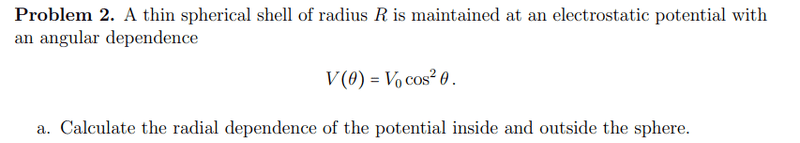

Need help with setting up the first part of the problem.
See solution.
Problem:
Solution:

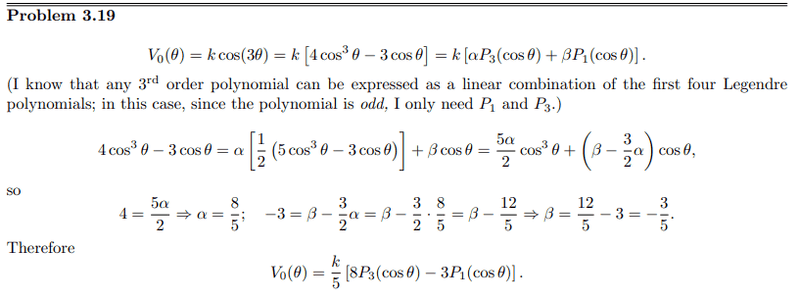

When I looked at an example problem, they started writing the potential in terms of the Legendre polynomials.
The example problem:
This is what I did:
$$V_0 \alpha P_2 (\cos(\theta)) \Rightarrow \frac{\alpha 3 \cos ^2 (\theta)}{2} - \frac{\alpha}{2} \Rightarrow \frac{\alpha 3}{2} - \frac{\alpha}{2}= 1 \Rightarrow \alpha = 1$$

Also with radial dependance do they just mean calculate A_l and B_l?
Yes you are supposed to find ##A_\ell## and ##B_\ell## and plug them into the generic formula
##V \left(r, \theta \right) = \sum_{\ell = 0}^{\infty} \left( A_\ell r^\ell + \frac{B_\ell}{r^{\ell + 1}}\right) P_\ell \left( \cos \theta\right)##
On physical grounds ##A_\ell = 0## outside and ##B_\ell = 0## inside because we cant have the potential blowing up at infinity or at the origin.

You may want to start with [tex]
\left.\begin{array}{r}
P_2(\cos \theta) = \frac{1}{2}(3 \cos^2 \theta - 1) \\
P_0(\cos \theta) = 1 \end{array}\right\} \quad \Rightarrow\quad
\cos^2 \theta = \frac23P_2(\cos \theta) + \frac13P_0(\cos \theta)[/tex]

No. Write out the righthand side as a polynomial in ##\cos\theta##, and you'll see it doesn't equal the given ##V(\theta)##.
In the example problem, you have the potential ##V = k \cos 3\theta= k(4\cos \theta^3-3\cos\theta)##, which is a third-order polynomial of ##\cos\theta##. That means it's an element of the vector space consisting of polynomials of degree 3 or fewer.
The first four Legendre polynomials are a basis for this vector space, so any element of the vector space can be expressed as a linear combination of the Legendre polynomials. In other words, you can say
$$4k\cos^3\theta - 3k\cos\theta = c_3 P_3(\cos\theta) + c_2 P_2(\cos\theta) + c_1 P_1(\cos\theta) + c_0 P_0(\cos\theta).$$ The problem is then finding the appropriate values for the ##c_i##'s.
A straightforward way to do that is to simply expand out the righthand side and then equating coefficients from the two sides of the equation. You'll get a system of four linear equations which is simple to solve. Griffiths used a useful shortcut to deduce ##c_0 = c_2 = 0##, so he ended up with a system of two equations and two unknowns.
In your problem, you have ##V=V_0 \cos^2\theta##. It's an element of the vector space consisting of polynomials of degree 2 or fewer, and the first three Legendre polynomials will span that space. So the problem is to find ##c_0##, ##c_1##, and ##c_2## so that
$$V_0 \cos^2\theta = c_2 P_2(\cos\theta) + c_1 P_1(\cos\theta) + c_0 P_0(\cos\theta).$$ Expand the righthand side and then equate coefficients to get the equations you need to solve.
Likes milkism, PhDeezNutz and vanhees71
