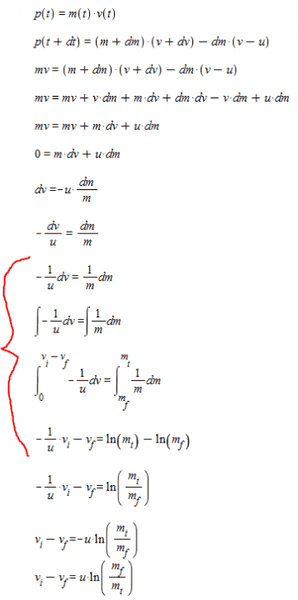

hello there
Im trying to do a derivation of tsiolkovsky's rocket equation, but i got stuck at the step when i have to use separation of variables (marked with red in the pic), i used maple to solve it, so i could get on with it, but i want to understand what is happening to solve this, so can anyone explain how to solve this step with separation of variables?
Thanks :)
It is exactly what they have done. What step in particular do you have problems with?

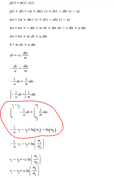

ok thanks so i have done some right ;)
im having trouble explaining what is happening, or i think i do.
I can explain the first steps, just isolate the variables on each side of the equation.
But what rules are used/how is this integrated (the bordered step)
Thanks :D
You integrate both sides between the same points. It is essentially making an integration and then making a change of variables.
Thanks i see now :D
Oh, and the integration boundaries on the LHS should be ##v_f## to ##v_i##. In this particular example it does not matter for the result because the integrand is constant. You then make a change of variables to ##m(v)## and use ##m_f = m(v_f)## and ##m_i = m(v_i)##.
