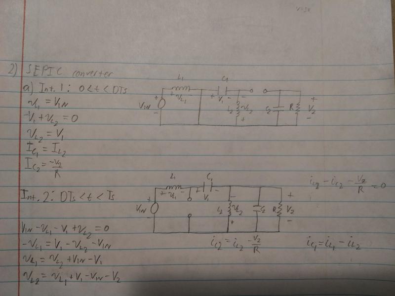

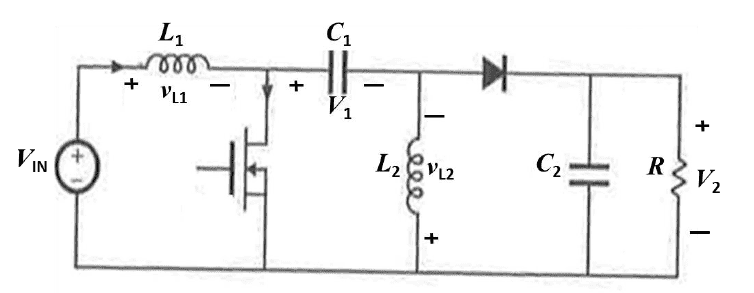

Find expressions for VL1, VL2, IC1, IC2 for each of the two intervals of a SEPIC converter under CCM operation.
link: http://i.imgur.com/EY98QbC.png
link: http://i.imgur.com/SskXRoC.jpg?1

No. Homework has been turned in though. The solution will be available to me soon.
Please post when you have it, thanks!
