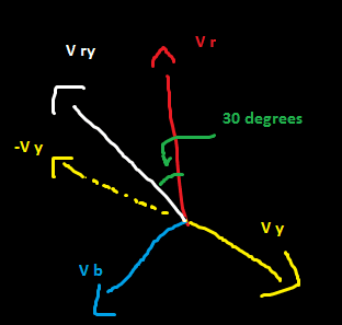

Cause in 3-phase line current leads phase current by 30 degrees.
Can you give me a reference that explains the origin of the alleged 30 degree shift.
Here you go:
As you see, line voltage leads phase by 30 degrees.

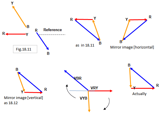

I think your RYB are wrong. Y has to lag R by 120 degrees. Your Y is leading R by 120 degrees.
If the fig.8-11 is the correct sketch then according to the arrow convention VRY it has to be R on the head and Y on the tail.

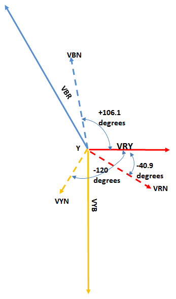

In my opinion, if you have not a neutral the sum of currents has to be 0 and the sum of voltages
to neutral also [it does not important if they are balanced or not].
Likes jaus tail
Can you explain why in the circled part in post#1, why have they not included phase lag of 30 degrees?
I think this article author made a mistake confusing the line-to-line voltage with line-to-neutral.
The currents IR,IY and IB are per phase and not per line-to-line.
One has to calculate the voltage phase-to-neutral, at first. By the way the 1Ω per phase impedance it could be only resistance-according to standard symbol.
For instance VRN= 159.6A<141.2degrees and it is not 200/√3 <180.
But it's star connection. Line current n phase current are same.
What do you have is VRY. What do you need is VRN [IR=VRN/Z] VRN<>VRY/SQRT(3)

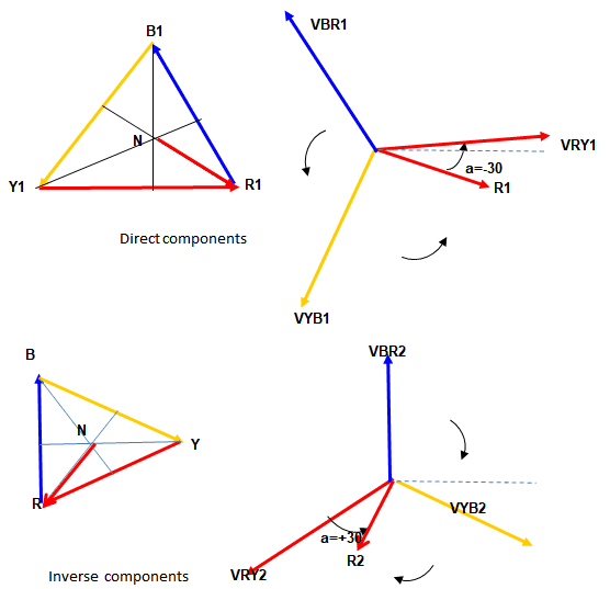

You may also follow Symmetrical Components-as Baluncore proposed:

Sorry. Direct components=positive components and inverse =negative [zero components=0].
The -30 or +30 degrees are for line-to-neutral symmetrical components with respect the symmetrical line-to-line components and not for the actual[total] VRN with respect to VRY.The actual VRN it is the result of vectorial sum of VR1 and VR2 [and VRo=0].

Actually what do you need it is only-I think-positive components of these currents.
The phasor diagram presents only the voltage-or current-positions one with respect to another. You may start for the first voltage [VR1 for instance] any where in the diagram that means you can start at 180 degrees as -30. VR1[positive sequence module of VRN] =VRY1[positive sequence of VRY]/sqrt(3) and you may start at 180 degrees[or not important at other angle]. It was very simply indeed.
