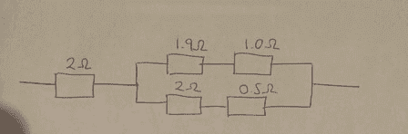

Hi guys, how do I figure out whether components are in series/parallel with each other just by looking at them? for example, in the circuit on the picture I posted, how do I know which of the resistors are in series/ parallel with each other? I know the definition involves nodes, but in clear, accurate sentences, when are components in series/parallel with each other?
Thank you :).

A series connection is one where the current has no other path other than to the next component. Parallel is when both the positive and negative sides of each component are connected to each other.

So a component is in series w/ another component when the current flowing from one of the components does not flow through a junction to reach the other? and can you elaborate on the parallel components part?

your circuit has a mix of series and parallel
we will guide you here at PF, but we would like you to make a good effort to work this out yourself :smile:
so for a start identify some series resistors and then identify some that are in parallel
hint ... some of the series resistors can be added together to make a simpler circuitDave

Thanks for all your replies! I'm learning series/parallel circuits atm so I have to look at the circuit that way. I've guessed that the top two resistors are in series w/ each other, the bottom two are in series and them 4 resistors are in parallel with the 2 ohms resistor, but that's just a lucky guess. I also know how to combine resistors. My problem is finding specific definitions/rules for what makes components in series/parallel with each other. Can anyone give me this?
The 2 ohm resistor is in series with the network of 4 resistors. Not parallel like you say.
Imagine sliding the resistors physically together on the schematic until they run into each other and become one resistor. That would be in series. Their combined resistance adds. Do that with both the upper and lower resistors and then go from there. Redraw the circuit several times if necessary.

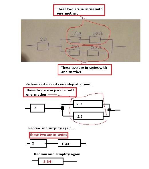

Post #2 gives perfectly reasonable rules for working it out.
If you can draw a dotted line around a pair of resistors, to include their connections, it is easy to apply those rules to decide whether they are series or parallel connected. Alternatively, rather than asking for some sort of bomb-proof rule, just look at some of the thousands of examples that Google will throw up and use the 'machine learning' method of finding a rule that works. Learning this sort of thing 'by numbers' is really not the best way, you know. You need to be after some understanding and not just learning rules.

Here's the step by step process you should go through for your circuit, actually redrawing it for every step.
That's how you learn to think like an electron oops make that 'think like a charge carrier' .

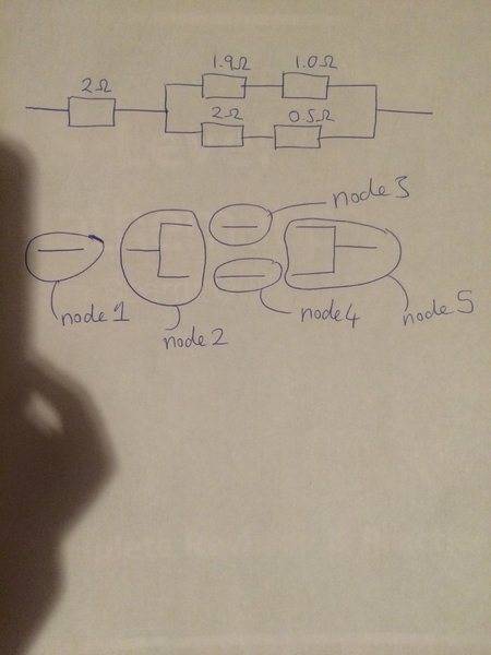

Hi, I agree. I've done many examples before which I got right most of the time, but I was curious to find out if there actually are any rules on how to determine series/parallel components. My lecturer stated some rules one time but then contradicted himself in the next lecture which confused me. So after doing some examples, I tried to find some rules which I wrote:
How you can determine if components are in series or parallel with each other, without having any of their current, voltage, resistance etc values:
Components are in series with each other if they have the same current flowing through them (i.e. if there are NO junctions between these components, since the current splits at a junction, causing there to be less/different current flowing through the other component). Components in series with each other must also share at least one node with each other.
Components are in parallel with each other if they don’t have the same current flowing through them (I.e. if there is at least one junction between these components, since the current splits at a junction, causing there to be less/different current flowing through the other component). Components in parallel with each other must also share only two nodes with each other.N.B: When I say ‘junction’, I do NOT mean ‘node’, I mean a point where the current can split.
N.B: The current in a circuit flows from the point of highest voltage to the point of lowest voltage.
Can anyone tell me if there's anything wrong here ^?

Components are in series with each other if ALL the current that flows through ONE of them MUST flow through the other.
That requires there be no path or junction or node where a current split could happen.
xJJx said:
Components are in parallel with each other if they their respective ends are directly connected to one another's
That forces them to experience the same voltage. "Directly" might be a long crooked wire or serpentine line on a schematic ; just make sure it's continuous.
Think in small baby steps one thought per sentence.
This basic concept is one where the plumbing analogy will help you . Soon it'll be intuitive so you can move on past the water analogy and its pitfalls..
