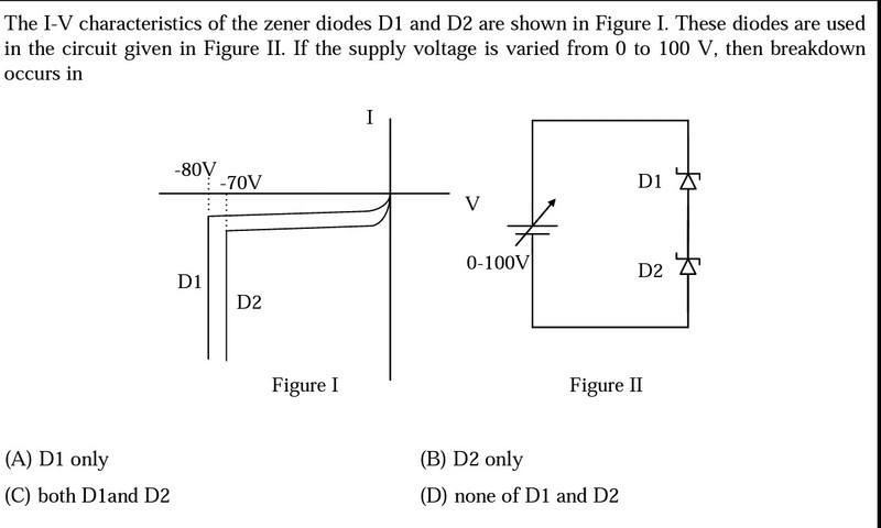

Series connected zener diodes problem

I have attached the image with post.
Answer to question is given as A. I am not getting the explanation to how can one zener diodes be in breakdown and other not. I think if the combined voltage of 150V is applied then only breakdown occurrs in both the diodes simultaneously.
You are right: The answer is D) as for Vsupplied < 100 V.
D1 and D2 will conduct some small amount of current, sharing the supplied voltage, but the voltages VD1+VD2 < 100V are not defined as break down voltages.
Maybe we should ask the question instead as:
"Does some arbitrarycurrent I100 exist
where the sum of the diode voltages is 100 volts? "
Surely there does.
The diodes see the same current of course ...
Any given current would be a horizontal line on the graph
and where it crosses each diode's characteristic curve is the voltage for that diode at that current.
so let's take a ruler and dividers to it .

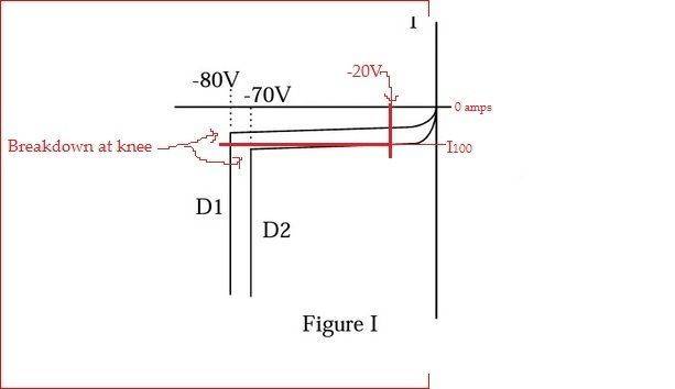

Sliding my red horizontal current line down from zero amps
it appears D1 breaks down at 80 volts well before D2 reaches even 20 volts
so if i lay my horizontal current line so it crosses D2's characteristic curve at 20 volts
i have found one possible I100 .
It seems strange that those two diodes have such different avalanche currents
but those are the curves we were given.
I'd have to pick answer A.
I think this was more an exercise in graph reading than zener diodes ?
