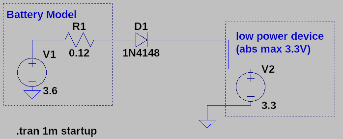

I'm designing a device that consumes 450nA in idle (up to 2mA peak) and the maximum allowed voltage is 3.3V. The power is supplied by a battery with a voltage of 3.6V.
One of the problems I've run into is: All LDOs I could find have a quiescent current consumption (Iq) greater than 450nA. The one I ended up choosing is the TPS7830 with an Iq of 500nA, but I was wondering whether it be possible to instead use a series diode to drop the 3.6V down to ~3.0V and save those 500nA.
Of course, the "0.7V rule" for diode forward voltages does not apply with these kinds of currents. It got me wondering: If I were to use a diode in this situation, would it end up damaging the ICs that have an absolute maximum rating of Vcc=3.3V? Or would the overvoltage cause an increase in current through the diode, enough to increase the diode's forward voltage and drop Vcc to a safe level? Is there a way to calculate this current?
It seems strange that an almost "static" overvoltage could cause damange to an IC, because as soon as you start drawing any amount of current necessary to cause permanent damage, the voltage would drop to a safe level.
Are there perhaps other options besides LDOs and series diodes that consume less current?

...I'm not sure how you drew this conclusion. I clearly stated that this is battery powered and there is a series diode with very little current, and the voltage the diode would drop over the diode is 0.3V, meaning the diode will be nearly non-conducting.
Maybe I didn't explain the problem properly. I'll try to answer my own question because I think I understand it.
The question I want answered:
Can the device be damaged if exposed to a (conceptually initial) voltage that is higher than the maximum ratings (see picture).
The anwer:

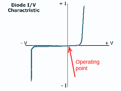

No it will not. In theory, as Vcc is increased over 3.3V the device will start consuming a lot of current (which would lead to permanent damage if you did this for a longer period of time). We can model the worst-case scenario by making the device a 3.3V voltage source:
Because the drop is only 0.3V (3.6 to 3.3), the operating point of the diode will be here:
In other words, the diode is in a non-conducting state (a simulation with the 1N4148 shows 2uA) and therefore the device is not harmed.

TheComet said:
No it will not.
there are dangers other than overheating the device. A high voltage can cause damage to silicon devices permanently changing their functionality.
The first crude silicon diode rule says 0.7V at 10 mA. The second crude Si diode rule says 0.1V per decade of current change.
10 mA = 0.7V, 1 mA = 0.6V, 100uA = 0.5V, 10uA = 0.4V, 1uA = 0.3V. Everything is dependent on diode area.
For a zero (<1 nA) increase in quiescent current I would consider an old N-channel depletion mode FET wired like a simple constant current sink, but with the source resistor replaced by the voltage sensitive device. You need a pinch-off Vgs of maybe 3.1 volt.
Select the FET to have Vgs = 3.0V with a 6M8 resistor in place of the device. ( 3.0V / 450nA = 6.66Meg ohm ). The FET will carry the 2mA Imax without a problem. I am not sure at those low currents but would look at things like the 2N5484, 2N5485 and MPF102 or similar. Look at the data sheet to find the pinch-off voltage and the operating point over the current range expected.
