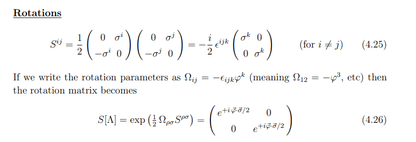

I was a bit stuck once I got ##(***)## but then I recalled I came across rotation block matrices ##S^{ij}## containing Pauli matrices while studying Tong's notes (page 85). They are given to be
$$S^{ij} = \frac 1 2 \begin{pmatrix}
0 & \sigma^i \\
-\sigma^i & 0 \\
\end{pmatrix} \begin{pmatrix}
0 & \sigma^j \\
-\sigma^j & 0 \\
\end{pmatrix}=-\frac{i}{2} \mathscr{E}^{ijk}\begin{pmatrix}
\sigma^k & 0 \\
0 & \sigma^k \\
\end{pmatrix} \tag{4.25}$$
Where ##\mathscr{E}^{ijk}## is the Levi-Civita symbol .
We note that ##(4.25)## only holds when ##i \neq j##. Thus we could define a rotation parameter ##\Omega_{ij} = -\mathscr{E}_{ijk} \varphi^k##. Then Tong asserts that the rotation matrix ##S^{ij}## becomes
$$S[\Lambda]=\exp(\frac 1 2 \Omega_{\rho \sigma}S^{\rho \sigma})=\begin{pmatrix}
e^{\frac 1 2 i \vec \varphi \cdot \vec \sigma} & 0 \\
0 & e^{\frac 1 2 i \vec \varphi \cdot \vec \sigma} \\
\end{pmatrix} \tag{4.26}$$
OK.
Coming back to the original problem b)
I was hoping to be able to use the above to solve the b) but I noticed that in ##(4.25)## we need to be dealing with ##i \neq j## if we want to get ##S^{ij} \neq 0## and in ##(***)## we're dealing all the time with ##\sigma_2##; so either ##(***)## is wrong or the rotation matrices provided by Tong are not useful to solve this particular problem.
PS: I may be overcomplicating things though.
Take another look at eq(4.9) in Tong's notes, and the following paragraph.
A finite Lorentz transformation takes the form of Tong's eq(4.10). Which elements in Tong's ##\omega^\mu_{~\nu}## must be nonzero to get a rotation in the ##(x^1,x^2)##-plane?
So yes, you were indeed overcomplicating it again. The answer is (almost) staring you in the face in Tong's eqns (4.9) and (4.10). Take the square of the matrix ##M^{12}##. Which terms remain zero? Do the same with the cube of ##M^{12}##. You'll find simply that the Taylor series I hinted at involving just the 2D matrix ##\sigma_2## remains nestled inside the 4D matrix.

OK I see we can construct a basis for the antisymmetric matrix ##\omega^\mu_{~\nu}##. Such a basis ##(\mathcal{M}^{\rho \sigma})^{\mu}_{ \ \ \nu}## contains 6 independent elements (3 boosts and 3 rotations).
Rotations basis elements are ##(\mathcal{M}^{1 3})^{\mu}_{ \ \ \nu}##, ##(\mathcal{M}^{2 3})^{\mu}_{ \ \ \nu}## and ##(\mathcal{M}^{1 2})^{\mu}_{ \ \ \nu}##
I see that ##(\mathcal{M}^{1 2})^{\mu}_{ \ \ \nu}## generates rotations around the ##x^3## axis, which are the ones they are asking at b). Then by Tong's ##(4.10)##
$$\omega^{\mu}_{ \ \ \nu}= \frac 1 2 \Omega_{12} (\mathcal{M}^{1 2})^{\mu}_{ \ \ \nu}$$
And the rotation parameter is indeed ##\Omega_{12}##

OK I now understand the statement 'only when ##\epsilon_{12}## does not vanish we get a rotation around the 3-axis over an angle ##\epsilon_{12}##'; they mean that only when the z-coordinate remains unchanged we get a rotation around the z-axis.
However, they want us to show it explicitly in terms of ##\epsilon## and matrix notation. Does that mean we have to introduce the Levi-Civita symbol and proceed like below:
Similar, but not exactly like that. The text you've reproduced looks like how one would represent 3D rotations that act on a Dirac 4-spinor. But in previous posts you've been working rotations acting on ordinary 3-space vectors. To understand this distinction better, I suggest you take your ##R_i(\theta)## matrices, (where ##i=x,y,z##) and compute their corresponding generators.
If you don't know what a "generator" is, it's the thing you use in the exponential version of a rotation matrix. So to recover a generator from the corresponding finite transformation, just differentiate wrt ##\theta## and then set ##\theta=0##.
So for each of your ##R_i(\theta)## matrices, you'll get a "##J_i##" generator matrix.
Further exercises:
1) Show that the set of the 3 ##J_i## matrices form a Lie algebra. (If you don't know what a Lie algebra is, then consider it part of this exercise to look that up.)
2) Show that the set of the 3 ##J_i## matrices form a vector space, in the sense that any linear combination of them is in a fact a generator for some 3D rotation.
3) Show that ANY finite 3D rotation can be obtained by exponentiating a linear combination of the ##J_i##'s, (meaning that exponentiating any such linear combination yields a finite 3D rotation matrix).
[Btw, if you haven't yet acquired a copy of Greiner's "Quantum Mechanics -- Symmetries", I can assure you it would be money well spent. I learned a vast amount from that book when I was getting started into serious study of QM. Greiner's textbooks are good for a beginner student because they give lots of worked examples, and he doesn't skip steps in the detailed computations.]
Likes JD_PM
