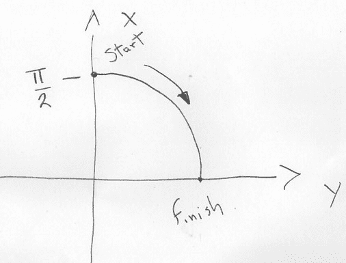

Did I get the path in rotation space of a rotating top that processes in the Earth's gravitational field right? Both the angle and orientation change at constant rates giving some kind of conical spiral path in rotation space?
Thanks.
Let's say rotations are positive clockwise, viewed from the ball's centre.
If in the cube diagrams the x-axis is positive into the page and the y-axis positive right, then yes.

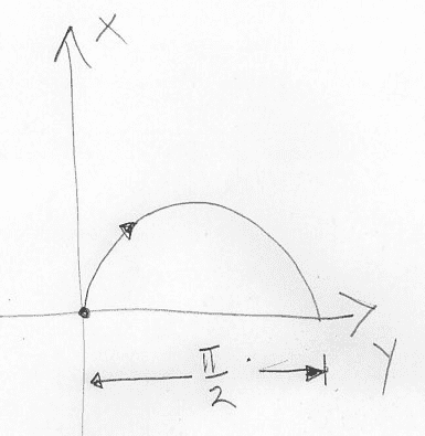

lavinia said:
This path traces a circular arc in the 3 ball.
Is the following the path?
Thanks.
Thanks.
On the 3 ball digram the curve lies on the sphere of radius ##π/2##. Such a curve has the property that it is a path of rotations which all are rotations of an angle of ##π/2## from the initial position. Instead of rotating with a fixed axis, this path changes the axis keeping the angle of rotation fixed.
