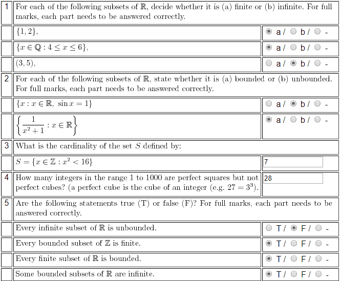

Could someone please check if these are right?
One part of q.1 is wrong. Everything else looks correct.
Re: Set Theory Questions (check if irght)
Which one? Looks alright to me.
Only finitely many rational numbers between 4 and 6 ? (Doh)
Isn't there a finite number of rational numbers for 4<x<6 ?
What about the numbers $4 + \dfrac1n$, for $n=1,\,2,\,3,\,\ldots$ ?
Oh nvm
I was thinking about countable and uncaountable.
