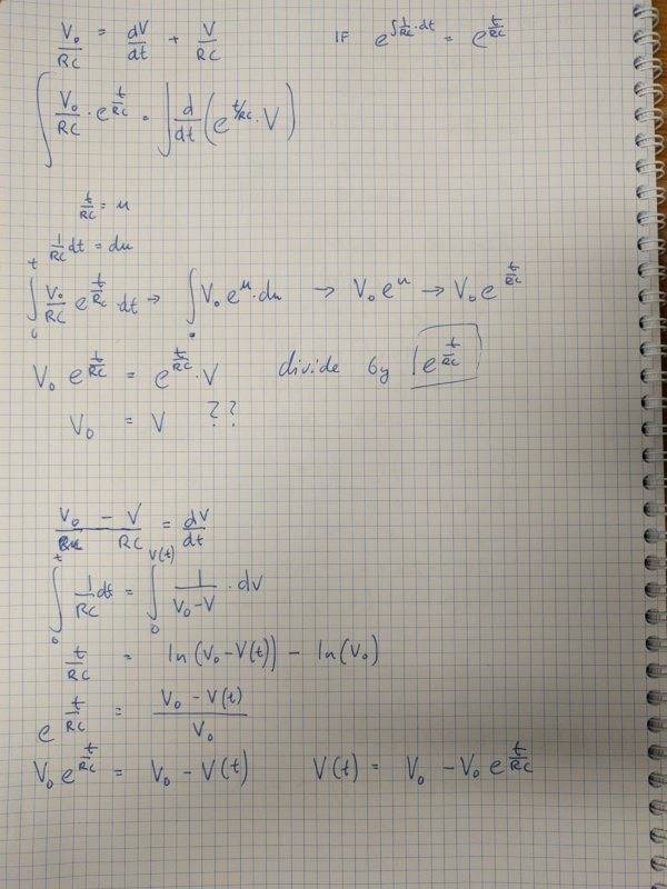

Hi @doggydan42 thank you.
I tried to make a clean version of what happened. I didn't upload the work previously because once i get confused it becomes a mess that only I can read.
First is the integrating factor.
I was able to solve the latter for the right solution, though if I use -dV/dt for the current in the loop.
instead of dV/dt in the equation, you mentioned was correct.
I feel really silly, I know I'm making a sign mistake, but I just seem unable to locate where.
thank you for helping!
You're missing a constant that you need to solve for using an initial or boundary condition.
Edit:
It looks like you are incorporating the initial condition into the integral as one of the bounds. But you have to use that as a bound instead of ignore it.
Edit 2:
In your latter solution, watch what you are integrating over, and look at the signs. Try a u-substitution to make it clear.
Likes spsch
Edit:
Edit 2:
Hi doggydan42, could it be that the differential equation should be : ## V_0 = -\frac{dV}{dt}RC + V ## ?
I don't believe so. Solve the earlier differential equation using your first method again. It looks like your mistake is setting ##e^0=0## when evaluating the integral over the bounds.
Likes berkeman and spsch
Omg! You're right doggydan42, I evaluated e^0 as 0 instead of 1. I made this mistake each time I solved it. It's so frustrating, these simple things seem to still happen to me so often. (This morning I was working on another problem where I kept 2*1 = 3 and couldn't figure out what I was doing wrong.)
Thank you very much. I'm so sorry, I really worked through it about 10 times and I seem to have always automatically discarded e^0 as 0.
