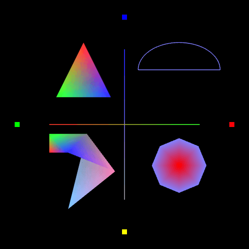

This is a simple WegGL 3D canvas example and I'd like to go over primarily the loading of the data and the 3D placement of the objects. And note even though the display looks 2D, when the HTML file is loaded, it becomes a 3D canvas with the z-axis coming out and going into the screen as discussed below and in the learning exercises cited here.
Refer to https://developer.mozilla.org/en-US/docs/Web/API for information about the OpenGL interface.
The following is a slight modification of Lesson 01 at http://learningwebgl.com/blog/?page_id=1217
I'm running this code locally on my machine so I specify an absolute reference on my pc for the matrix code:
JavaScript:
<script type="text/javascript" src="c:/js/glMatrix.js"></script>
So if you want to experiment with this wegGL example, you'll have to download the glMatrix.js code from the learning site, and edit the src command as necessary before running it.
We wish to establish a WebGLRenderingContext in an HTML <canvas> object. This will give us the OpenGL interface to render objects in the web page using WebGL. We do this with two statements in the webGLStart function (complete source code is below):
JavaScript:
var canvas = document.getElementById("lesson01-canvas");
gl = canvas.getContext("experimental-webgl");
and we set the width and height of the canvas at this time. Once we obtain the gl object, we will use it to call the various canvas methods to set up and display the GL graphics in the canvas. A list of canvas methods can be found at https://developer.mozilla.org/en-US/docs/Web/API/WebGLRenderingContext
We implement the following steps in the webGLStart function:
1. initShaders
2. initBuffers
3. configureCanvas
4. drawScene
The shaders basically instruct the graphics card how to shade the scene and is a bit complicated for me right now and I'll just skip for now. The lesson above goes over the shader in detail. What I’d like to discuss now is setting up the data to display the scene and it’s important to note we establish a 3D drawing surface in the webgl context with the z-axis going into the screen for negative values and out of the screen for positive values (we limit the view to 0.1 and -100) . So that when we position objects on the canvas with the code:
JavaScript:
mat4.translate(mvMatrix, [x,y,z])
and position object1 with a z-value of -2 and then position object2 with a z-value of -3, object 1 will be in front of object2 and object2 will appear slightly smaller since this is a projective view.
In this application, I draw a set of lines, a square, and a triangle using the following procedures in the code below:
1. create buffer
2. bind buffer
3. load buffer
And for more informationf about these functions, refer to the learning exercies and WebRenderingContext.bufferData at https://developer.mozilla.org/en-US/docs/Web/API/WebGLRenderingContext/bufferData
We have in the source file:
JavaScript:
// Set up buffer for line
        lineVertexPositionBuffer = gl.createBuffer();
        gl.bindBuffer(gl.ARRAY_BUFFER, lineVertexPositionBuffer);
        vertices = [
             -1,0,0,
              1,0,0,
              0,1,0,
              0,-1,0
        gl.bufferData(gl.ARRAY_BUFFER, new Float32Array(vertices), gl.STATIC_DRAW);
        lineVertexPositionBuffer.itemSize = 3;
        lineVertexPositionBuffer.numItems =4;
and the format of the buffer will differ according to what object is being loaded. In the case of a line buffer, we store starting and ending points in 3D for a line so in the example above, we have the (x,y,z) coordinates for the x and y axis. The itemSize gives us the length of each item (3), and the numItems gives the length of the buffer. And we use the same basic procedure to load data for additional objects.
Once we've loaded the object array, we can draw it in the canvas paying particular attention to the z-coordinate. The important function below is the mat4.translate(mvMatrix,[x,y,x]) command as this translates our view before drawing the object. Below, once we've set up a projective display with objects farther away appearing smaller, we initialize the view with the identity matrix which just sets the view at the origin. And note below, in preparation for drawing the cross-hairs of the x-y coordinate system, we translate -10 into the field of view. Had I translated only -5, the crosshairs would appear larger since they would be closer in the view. It's important to note that the translate operations are composite transformations. That is, once we translate back into the screen with [0,0,-10] we remain there until we move the view from that location with anoter translate. For example, if we followed that command with a translate to [-2,0,0], then we would still be -10 into the screen but translated to the left by 2 units. Following that by the translate command [0,0,8] keeps us 2 units to the left but now we have advanced out of the screen by 8 units sothat when we draw the next object, it would be in front of the object drawn before this command and appear larger. And so forth. This way we can efficiently move about the canvas with a simple translate command.
JavaScript:
      gl.viewport(0, 0, gl.viewportWidth, gl.viewportHeight);
        gl.clear(gl.COLOR_BUFFER_BIT | gl.DEPTH_BUFFER_BIT);
        mat4.perspective(45, gl.viewportWidth / gl.viewportHeight, 0.1, 100.0, pMatrix);
        mat4.identity(mvMatrix);
// now do line
        mat4.translate(mvMatrix, [0,0,-10]);
        gl.vertexAttribPointer(shaderProgram.vertexPositionAttribute, lineVertexPositionBuffer.itemSize, gl.FLOAT, false, 0, 0);
        setMatrixUniforms();
        gl.drawArrays(gl.LINES, 0, lineVertexPositionBuffer.numItems);
and we follow this set of commands with similar command for the square and triangle although the format of the data is slightly different and described in the lesson site. The following is the complete HTML source for this example:

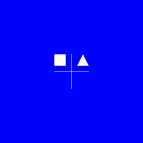

// draw triangle
        mat4.translate(mvMatrix, [2, 2,-20]);
        gl.bindBuffer(gl.ARRAY_BUFFER, triangleVertexPositionBuffer);
        gl.vertexAttribPointer(shaderProgram.vertexPositionAttribute, triangleVertexPositionBuffer.itemSize, gl.FLOAT, false, 0, 0);
        gl.drawArrays(gl.TRIANGLES, 0, triangleVertexPositionBuffer.numItems);
// draw square
        mat4.translate(mvMatrix, [-4, 0.0, 0]);
        gl.bindBuffer(gl.ARRAY_BUFFER, squareVertexPositionBuffer);
        gl.vertexAttribPointer(shaderProgram.vertexPositionAttribute, squareVertexPositionBuffer.itemSize, gl.FLOAT, false, 0, 0);
        gl.drawArrays(gl.TRIANGLE_STRIP, 0, squareVertexPositionBuffer.numItems);
    function webGLStart() {
        initGL(canvas);
        initBuffers();
        initShaders();
               gl.clearColor(0.0, 0.0, 1.0, 1.0);
        gl.enable(gl.DEPTH_TEST);
        drawScene();
</script></head><body onload="webGLStart();">
    <a href="http://learningwebgl.com/blog/?p=28">&lt;&lt; Back to Lesson 1</a><br />
<p> this is some data to print </p>
    <canvas id="lesson01-canvas" style="border: none;" width="500" height="500"></canvas>
    <br/>
<p> more data to print </p>
</body>
</html>

Hi,
I've been reading about OpenGL, shader programs and GLSL. Also got "Programming 3D Applications with HTML5 and WegGL". Of primary concern is to create shader and fragment programs written in the shader language GLSL to be passed to a WegGLContext program which is then linked into a rendering program with runs on the graphics card. Pretty complicated and just starting to learn about it. The User Manual for GLSL is here:
https://www.opengl.org/registry/doc/GLSLangSpec.Full.1.20.8.pdf
And I think one key to successfully implementing WegGL is to learn the shader language and experiment with it. for example, in my second program above, I added points to the canvas at the ends of the axes although they are square. This required a shader variable gl.PointSize added to the vertex shader and I specified a size of 10 but not sure what that refers to. These are some of my notes and I included the source for the canvas above:
The source for the shading programs is the shader-fs and shader-vs scripts in the HTML file. Note in particular the three types of GLSL variables that can be used in the shading programs: Attribute, uniform and varying. During the initialization of the shader programs, we read-in these scripts, compile, link, and bind them to the WebGLProgram. The following Javascript in getShaders() reads the source code from the scripts:
JavaScript:
        var shaderScript = document.getElementById(id);
        if (!shaderScript) {
            return null;
        var str = "";
        var k = shaderScript.firstChild;
        while (k) {
            if (k.nodeType == 3) {
                str += k.textContent;
            k = k.nextSibling;
At the end of this call, the string in str will contain the shader source. We follow these steps to implement the shaders which are implemented in getShader() and initShaders():1. Get shader source from shader-fs and shader-vs scripts
2. Create the fragment and vertex shader programs,
3. Compile and create the shader programs,
4. Create the WebGL program,
5. Attach the vertex and shader programs to the WebGL program,
6. Link the WebGL program,
All of these steps are implemented in the WegGLRenderingContext we set up in the variable gl. For example, to create a shader program, we call shaderProgram=gl.CreateProgram(). Once we initialize the shader programs, then in addition to initializing the vertex buffers for the shapes, we now add color buffers for the shapes. For example, I define the vertices for the triangle with:
var vertices = [
0.0, 1.0, 0.0,
-1.0, -1.0, 0.0,
1.0, -1.0, 0.0
And the colors for those verticies:
var colors = [
1.0, 0.0, 0.0, 0.81,
0.0, 1.0, 0.0, 0.81,
0.0, 0.0, 1.0, 0.81
This gives us Red, Blue, and Green for the three verticies with opacity of 0.81. We next add the following code to the drawScene function for each shape. For example, we use the following for the triangle.
gl.bindBuffer(gl.ARRAY_BUFFER, triangleVertexColorBuffer);
gl.vertexAttribPointer(shaderProgram.vertexColorAttribute,
triangleVertexColorBuffer.itemSize, gl.FLOAT, false, 0, 0);
gl.drawArrays(gl.TRIANGLES, 0, polyVertexPositionBuffer.numItems);
And we do this for each shape in the scene. Note the use of gl.TRIANGLE. This is one of several drawing methods used by WegGL. The method WebGLRenderingContext.drawArrays() has the following drawing methods:
1. gl.POINTS: Draws a single dot.
2. gl.LINE_STRIP: Draws a straight line to the next vertex.
3. gl.LINE_LOOP: Draws a straight line to the next vertex, and connects the last vertex back to the first.
4. gl.LINES: Draws a line between a pair of vertices.
5. gl.TRIANGLE_STRIP
6. gl.TRIANGLE_FAN
7. gl.TRIANGLES: Draws a triangle for a group of three vertices.
The square figures at the ends of the axes are actually large points I drew with the gl.POINT method. I don't yet know if I can round them off. I drew the axes with the LINES method, the 8-sided octagon I drew with the gl.TRIANGLE_FAN method and the figure in quad 4 I drew with the gl.TRIANGLE_STRIP method and for the half-ellipse in quad 1, I first computed the values for just half of it in Mathematica with Table[{1.5 Cos[t],Sin[t],0] and then just pasted the numbers into the Java Script code so that I could see how the LINE_LOOP would connect the first and last points. I computed the values for the octagon in Mathematica the same way.
Also, I migrated my code to NetBeans and cleaned it up a little. For example, I place all the global variables together at the top of the JavaScript.
Pretty interesting I think. :)

            lineVertexColorBuffer.itemSize, gl.FLOAT, false, 0, 0);
// draw triangle
        mat4.translate(mvMatrix, [-1.5, 2.0, -7.0]);
// draw ellipse
        mat4.translate(mvMatrix, [3.5, 0.0, 0]);
        gl.bindBuffer(gl.ARRAY_BUFFER, ellVertexPositionBuffer);
    ellVertexPositionBuffer.itemSize, gl.FLOAT, false, 0, 0);
        gl.bindBuffer(gl.ARRAY_BUFFER, ellVertexColorBuffer);
    ellVertexColorBuffer.itemSize, gl.FLOAT, false, 0, 0);
        gl.drawArrays(gl.LINE_LOOP, 0, ellVertexPositionBuffer.numItems);
// draw octagon
        mat4.translate(mvMatrix, [0, -3.5, 0]);
        gl.bindBuffer(gl.ARRAY_BUFFER, polyVertexPositionBuffer);
    polyVertexPositionBuffer.itemSize, gl.FLOAT, false, 0, 0);
        gl.bindBuffer(gl.ARRAY_BUFFER, polyVertexColorBuffer);
    polyVertexColorBuffer.itemSize, gl.FLOAT, false, 0, 0);
        gl.drawArrays(gl.TRIANGLE_FAN, 0, polyVertexPositionBuffer.numItems);
// draw triangle strip
        mat4.translate(mvMatrix, [-6, 0, -5]);
        gl.bindBuffer(gl.ARRAY_BUFFER, stripVertexPositionBuffer);
    stripVertexPositionBuffer.itemSize, gl.FLOAT, false, 0, 0);
        gl.bindBuffer(gl.ARRAY_BUFFER, stripVertexColorBuffer);
    stripVertexColorBuffer.itemSize, gl.FLOAT, false, 0, 0);
        gl.drawArrays(gl.TRIANGLE_STRIP, 0, stripVertexPositionBuffer.numItems);    }
        var canvas = document.getElementById("lesson02-canvas");
        initGL(canvas);
        initShaders();
        initBuffers();
        gl.clearColor(0.0, 0.0, 0.0, 1.0);
        drawScene();
</script>
</body>
</html>
Likes DrZoidberg and Pepper Mint

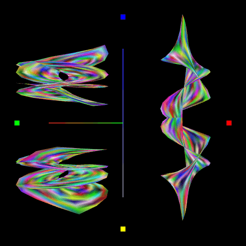

This is oh so cool! Here is the working version of it. I am really amazed at the blinding speed of hardware (GPU) acceleration!
https://dl.dropboxusercontent.com/s/xvkksd4vr4hbh6j/index.html?dl=0

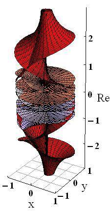

Some notes on migrating 3D data from Mathematica to HTML5/Javascript:
In Mathematica, I created the three branch plots above by computing traces along their branch surfaces in radial paths from 0.1 to 0.9 to create 1500 vertex points for each plot and then formed triangular polygons between each trace. The gl.drawElements(gl.TRIANGLES,…) method requires a 1D array of the vertices along with an index buffer identifying which vertices belong to each triangle. Data in Mathematica is delimited by curly braces so I had to switch these out for the javascript square brackets and then save both the vertex data and index data to a javascript-like file. For example, formed the "var branch2DataPoints" discriptor with the following Mathtmatica code (the 3D vertex data is stored in theTraceData):
functionVertexBuffer=Flatten[theTraceData];
myVertexData=ToString[functionVertexBuffer];
ilen=StringLength[myVertexData]
theDataPoints="var branch2DataPoints=["<>StringTake[myVertexData,{2,ilen-1}]<>"];";
When this is done, I now have a Java descriptor "var branch2DataPoints=[v1,v2,v3,...vn];"
I then do the same with the index buffer and save each branch data to "branchnData.js" in my netBeans project and then include a script;
<script text="text/javascript" scr="branch1Data.js"> </script>
for each branch in my HTML file.
In this project, I simply chose random colors for each vertex and then established a static animation to rotate each branch at a constant rate. It’s a simple matter to call tick() in the WebGLStart() function. Tick() then calls the animate() function which then controls the static rotation of the three function branches at constant rates. The animation code is explained in lesson three of the learning exercises: http://learningwebgl.com/blog/?p=239

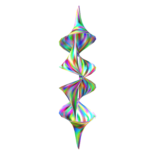

Hey guys. I finally got one to interactively rotate. Added some diffuse and directional lighting but not sure it's working properly. Code is really messy though.
<Moderator's note: old link deleted. See next post for correct link.>
Likes nolxiii
Hi guys,
I think I have it in the form I intend to publish on my blog. You guys have been great helping me get the code to work. Here's is the the version I like although the data for both real and imaginary parts is up to 4.5 Mb and takes a bit to load on slow machines. Would appreciate any suggestions for improvements:
https://dl.dropboxusercontent.com/s/dhdvgj0astxrah6/index.html?dl=0
