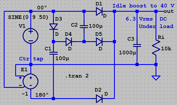

The problem with DC solenoid valves is that it takes more current to start the pull-in than it does to maintain that on state.
You need a high initial voltage to quickly get the current flowing through the coil. Then, once the solenoid has been pulled in, the voltage can be allowed to fall. To do that, you need two different voltages.
I have built voltage boosters into the DC supply to solenoids. While the solenoid is off, the booster slowly builds up to three times the supply voltage in the output capacitor. When the solenoid is connected, the high current flows, then falls to normal because the multiplier can only produce low current compared to the normal supply.
Likes Averagesupernova and berkeman
Here is a schematic for a boosted supply designed to provide a fast start for a solenoid. The power output of this circuit must be switched to one solenoid only.
V1 and E1 simulate a centre-tapped transformer with 9 V peak either side of the grounded centre-tap.
Full-wave rectifier, D1 and D2, provide 6.3 Vrms DC to the output, to hold the solenoid once it is in.
D3 to D5, with C1 and C2 form a half-wave voltage multiplier, while there is no load connected, that pumps up the output voltage on C3 to about 40 volts. C3 then provides the energy needed to initially pull in the solenoid. It takes a few seconds to build up that boost voltage.
The value of C3 must be selected to reliably pull in the solenoid.
Likes DaveE, Erik_clifton102 and berkeman
Thank you for your comment, I have found it to be very useful.
