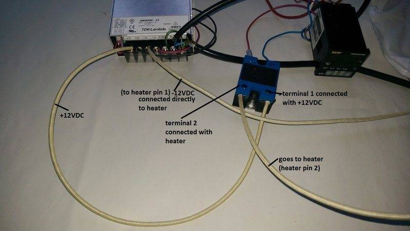

I have simplified my electric circuit for simple test to verify whether controller actually controls the powering of the heater.
My simplified electric circuit consisted of PSU, DC-DC SSR, 12VDC heater (controller was disconected from SSR but was powered and I could read the actual temperature of solution on the sensor).
What I have found out was that in this simplified circuit the heater was still powered!
The details of my simplified circuit were (there were only 3 cables used):
1 cable between PSU-heater - 12VDC "-"
1 cable between PSU-SSR - 12VDC "+" goes to '1' in SSR (LOAD side of SSR which is 40A 100VDC).
1 cable between SSR-heater - 12VDC "+" goes from '2' in SSR (LOAD side of SSR which is 40A 100VDC) to the heater.
Again '3' and '4' connections in SSR remained unwired.
There is only one explanation- this SSR is normally closed, which is not the case when I check SSRs specs in the web.
I am confused.
Can you sketch and upload this? SSR terminal 1 is output (-), and terminal 2 is output (+). It sounds like you have polarity reversed.

@Asymptotic
I have made a picture of the circuit and put some comments on it.
I had the same thought that perhaps I should swap the cables in terminal 1 and 2.
On the other hand, when I checked the connections done for AC load, the cable coming from PSU (line) was connected to terminal 1 and terminal 2 was connected to the heater.
What AC load?
Thanks for the photo. Kudom P/N KSJ100D40-L(068) SSR load wiring polarity is backwards. SSR terminal #2 should be connected to supply (V+), SSR terminal #1 to the heater, and the other side of the heater to supply (V-).
Add a properly sized heat sink to handle the 25A load current.
For 25°C ambient temperature convection cooling, this SSR must be de-rated to only about 17A when used without a sink, but is good for about 27 amps when bolted to a 2.1°C/W heat sink.

I have switched the cables between terminals 1 and 2 in SSR. The circuit works very good now. Thank you.
In regards to the sink. I have temporarily exposed SSR to the PSU fans blow. SSR is cold now. This electric circuit is for rapid prototyping. At later stage I will add a proper heat sink to it. Thank you for the info you have sent and the diagram. It is very useful. I will apply it.
