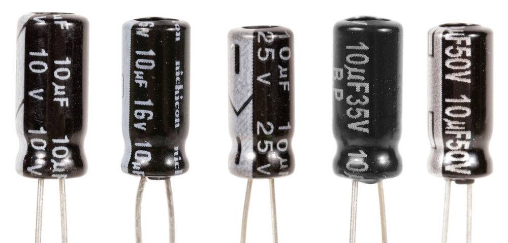

Do you mean "destroy"? You can destroy a capacitor by applying a voltage that is larger than it is designed for. Electrolytic capacitors often have the recommended maximum voltage printed on them:
