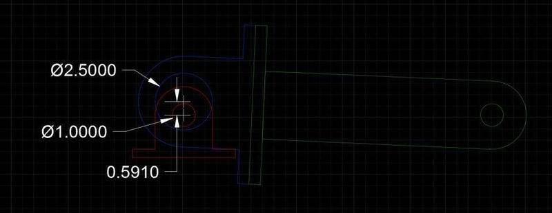

Here's an image of how I'd build it... The blue and red parts are pillow block bearings, and with this design the shaft can be cut out of one piece of 2.5" round stock, the big pillow block will go right over the smaller shaft, Admittedly it's a massive bearing and bigger than the load requires, but going to a smaller one will mean you need to only be able to drive it from one side, or need a real 3 piece crank to be able to assemble it.
If this is just a short term test rig that doesn't need to last long, and you can afford a little less rotation speed in exchange for a little more stroke, look at a dead 60cc chainsaw engine, it has about a 34-36mm stroke, the crank typically runs on 6202 bearings, has a connecting rod of about 70mm and has roller bearings.. I think the forces involved are seriously pushing the limits of what that design can handle, but it's what I can think of off the top of my head.
Lastly, you better have this thing anchored down really well.. it's going to walk all over the place!
