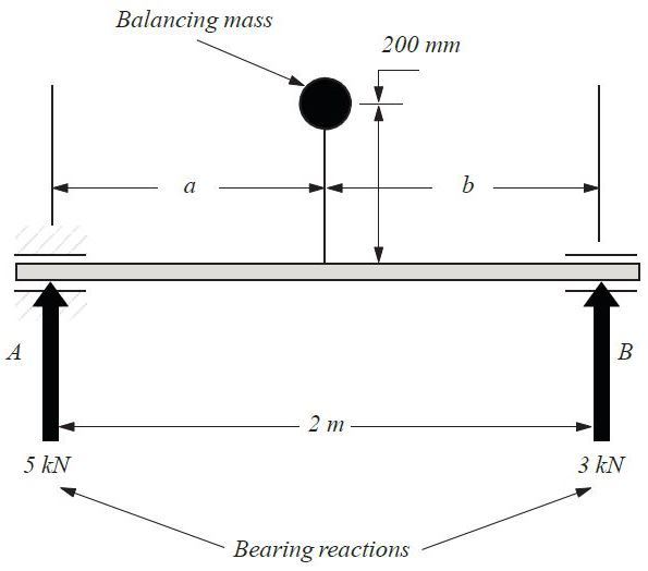

A shaft 2m long rotates at 1500 revs min-1 between bearings as shown. The bearings forces of 5kN and 3kN acting in the same plane as shown. A single mass is to be used to balance the shaft, so that the reactions are zero. The mass is to be placed at a radius of 200mm from the shaft centre, 180o from the direction of the bearing reactions. Determine the size and position (a and b) of the mass to be used.

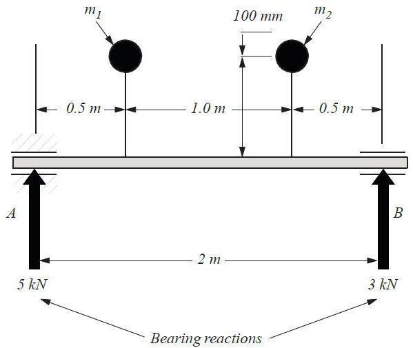

The shaft in part A is to be balanced using two mases (m1 and m2) placed 0.5m and 1.5m from end A and 180o from the direction of the bearing reactions, each on radius arms 100mm long. Calculate the sizes of m1 and m2.

A.
ω=1500 revs min-1=1500*(2π/60)=50π rad s-1
To balance the shaft the bearing reactions must equal to centrifugal force of the mass.
RA+RB=F
F=5kN+3kN=8kN
F=m*r*ω2
8000=m*0.2*50π2
4934.8022m=8000
m=1.6211kg
Calculating moment about RB
RA*2-8*b=0
10-8b=0
8b=10
b=1.25m
a+b=2m
a=2-1.25=075m
B.
F1+F2=8kN
Taking moment about RB
RA*2-F1*1.5-F2*0.5=0
10-1.5*F1-0.5*F2=0
1.5*F1+0.5*F2=10
F1+F2=8
1.5*F1+0.5*F2=10
Solving equation
F1=8-F2
1.5*(8-F2)+0.5*F2=10
12-1.5*F2+0.5*F2=10
F2=2kN
F1+2=8
F1=6kN
F1=m1*r*ω2
6000=m1*0.1*50π2
2467.4011m1=6000
m1=2.4317kg
F2=m2*r*ω2
2000=m2*0.1*50π2
2467.4011m2=2000
m2=0.8106kg
Did I got it right?
I'm not sure where I went wrong, but I suspect the m1 should be smaller then m2 as RA is bigger then RB. Any tips?

It looks right to me.
There is an easier way to do this.
Consider: At what location along the shaft, do the bearing reaction forces produce zero torque?
Likes sponsoraw
Thanks SammyS for you reply. Can you expand a bit more on that?
For part A:
Consider the moment about some point on the shaft, a distance ##\ x\ ## to the right of point A, the left end of the shaft. Find what value of ##\ x\ ## makes that moment zero.
##\displaystyle \ -(5x)+3(2-x)=0 \ ##
Likes sponsoraw
