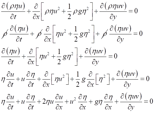

According to Wikipedia (I know, I just need basic resources for now), the conservative SWEs are
9b9d481407c0c835525291740de8d1c446265ce2
If I use product rules, I am supposed to get:
6bb10fdfb320a6bc0f4011b08b6b616b2a95929e
For context, note that ρ is a constant and can be taken out (thus canceled out), and η(x,y) = H + h(x,y) (H is a constant).
I have no issues getting the first line. The second line however, I am facing issues. This is what I have:
I intentionally did not distribute the derivatives with respect to y so I could see the problem more clearer. Am I missing something here with regards to the expansion of the PDE? Thanks in advance.

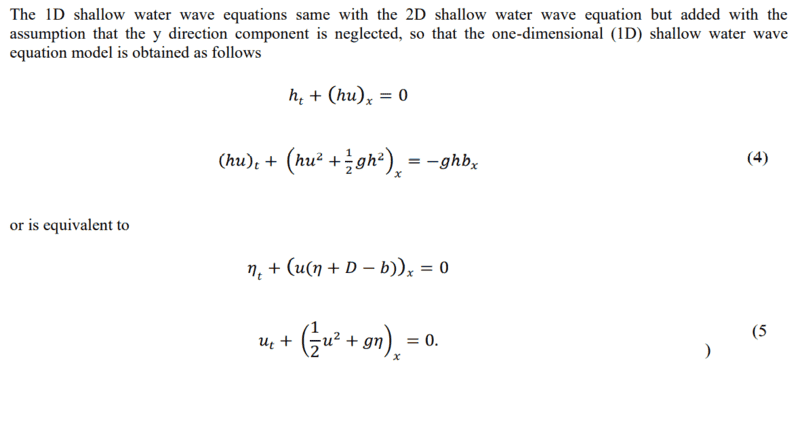

I found this paper that actually is the same 'issue' that I am facing, though they just presented it.
This paper:
https://doi.org/10.1063/5.0039545
It stated that:
I am having trouble understanding how the second equations have been made (second equation 4, to second equation 5).
The wikipedia entry on shallow water equations doesn't make sense to me. How could you, from equations derived using momentum and mass conservation, merely expand terms and get a non-conservative set of equations. No mechanical manipulation of equations changes the underlying assumptions they were derived from.
