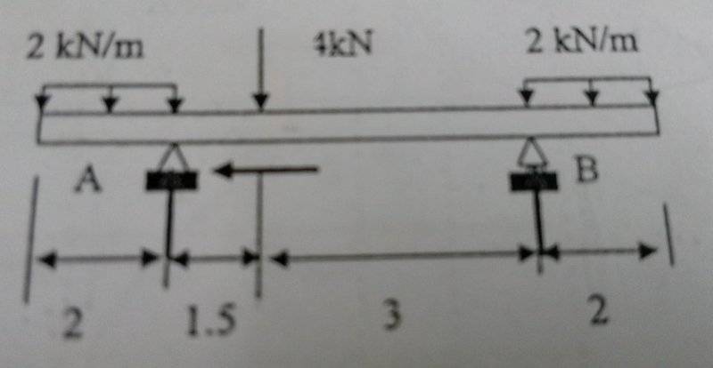

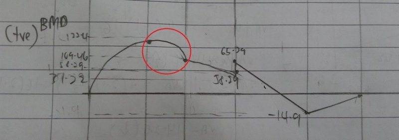

in this question , I'm asked to draw the bending moment diagram and shear force diagram
I don't have the ans for this question , can somoene check thruough my shape of graph . I'm not confident with it . [/B]

Oh so close,,,,but between B and the right end, the shear diagram is wrong,,,you have a distributed load there so the shear line is not horizontal. Your moment diagram them gets messed up between B and the end because of that shear error. And by convention, moment diagram is not mirrored like last time , this is a good thing

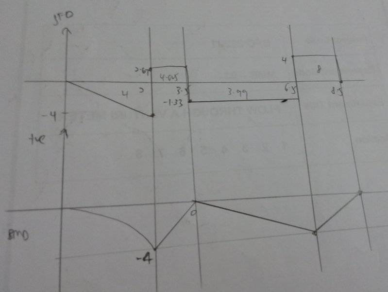

should the diagram look like this ?

I think you attached the wrong image I don't know what you did. It was almost perfect the first tine
