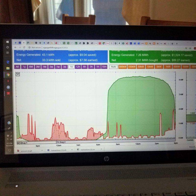

The second picture shows 24 hours of history for August 2. The red line shows energy consumption. The green shade shows energy sold to the grid. The red shade shows energy bought from the grid. Note that the green shaded area is not sinusoidal in shape. It approaches a square half cycle. I attribute that to the 2-axis motion system. The difference between the square shape and a sine shape with the same peak is a visual indication of the energy benefit of the 2-axis system.

Also in pictures 2 and 3 is a green dotted line (hard to see). I believe that is power generated by the two Tesla Powerwall units. They appear to be very underutilized. If they were owned and operated by the homeowner, I believe they would have played a bigger role. There is no way to tell how much skill and attention the utility invested in operating those batteries.

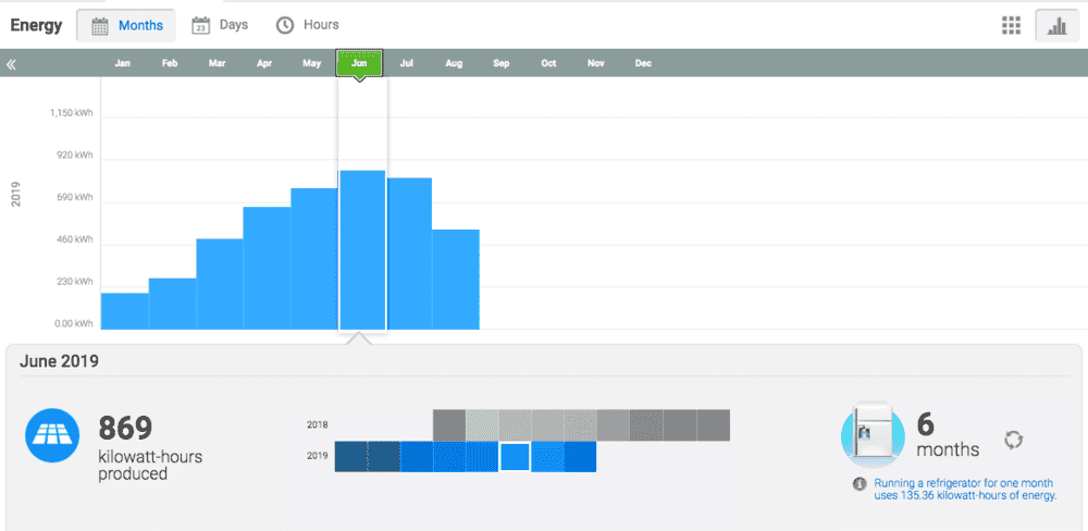

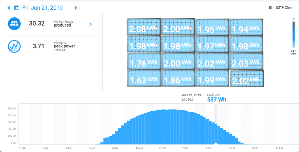

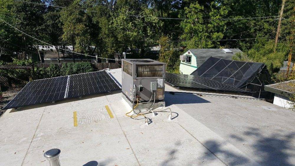

I have a much more modest solar array. I live in Northern California, and have a rooftop array with 16 300W panels, so the whole array is about 25 m^2. I have a nearly flat roof, so the panels lie flat on the two sides of the roof, which face East and West. A couple of the panels get shaded in the late afternoon, so I have micro-inverters, meaning that each panel has its own inverter. Averaged over the year, the array generates more power than I use, although I generate way more than I use in the summer, and less than I use in the winter. The local utility (PG&E) has net metering, so I basically pay nothing for electricity, although I do pay a small fee (about $10/month) to pay for the hookup to the grid and the fact that the utility guarantees me power no matter whether my array is generating or not.

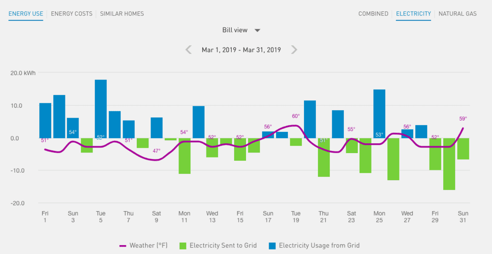

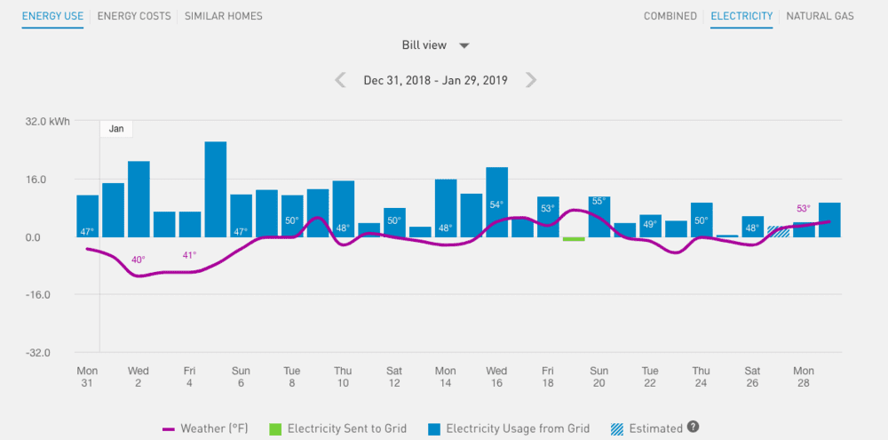

Below are some photos. First is a picture of the array, then the peak production in June, then the production so far this year. The next graphs are the net production (daily production minus use). In June I generate more than I use, in March I about break even, and in January I use more than I generate. The last graph is the annual net use. All in all, I'm very happy with the system.
