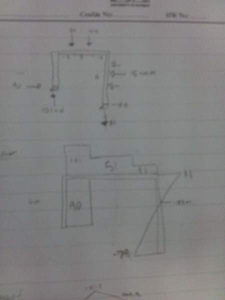

Draw the shear and moment diagrams for each of the three members of the frame. Assume the frame is pin connected at A, C, and D and there is a fixed joint at B.
Please i need help with this .. would be great if anyone can help
First, determine the reactions at A and D to keep the frame in equilibrium.
on A i got 101 KN up and 90 KN to right, at D i got -11 Kn , i am not sure if these are right
Well, that's easy to check.
Take your reactions an see if they equations of equilibrium are satisfied.
If not, rinse and repeat.
think i got the reactions correct but I am not sure bout my shear diagram doesn't look right
Well, I'm not sure either. You'll have to post it.
ok here is what I've drawn so far
It's kinda blurry - can't make out any details at all.
dw about the pic uptop just the shear diagram..does the shape look right
How do you know the reactions are right? There is no point drawing the moment and shear diagrams if the reactions are not right. The reactions are checkable. So please send your calcs.
i already sent my calculations. on reaction A i got 101 KN up and 90 KN to right, on reaction D i got -11 Kn downwards, i am going with these thanks for your help
I haven't seen calcs for reactions, which I believe are self-evidently not correct. (For example, what is the bending moment at point C? I am sure you would say 'zero' because of the hinge there, but have you checked by taking the algebraic sum of moments on each side of C?)
yes i am re doing the calculations now.. i will take a section at pin C and start summing from there
