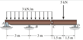

Draw the shear diagram for the compound supported beam.
Statics... so sum of moments at any point or forces in any direction are 0
I summed the forces in the y direction, as well as the moments at A and moments at B, but using these 3 equations causes the variables to cancel out when solving for the reactions. I get 0 = 0...
I guess I cannot use two moment equations, but then how am I to solve this? I'm in first year statics.
My equations are...
[tex]0 = \sum F_y = A_y + B_y + D_y -3*6 - 5[/tex]
[tex]0 = \sum M_A = B_y*3 + D_y*9 -3*6*3 - 5*7.5[/tex]
[tex]0 = \sum M_B = -A_y*3 + D_y*6 - 5*4.5[/tex]
Counter-clockwise moment is positive
You have a pinned joint at point C. Try splitting the single beam into two parts: A-B-C and C-D. Write separate equations of static equilibrium for each piece of the beam. What's the bending moment at point C?
Sorry, is the bending moment at C zero?
I tried getting isolating for [tex]C_y[/tex] but I keep getting [tex]C_y = 0[/tex]
Is the upward force at pin C the same as the "shear force" at C?

Yes. The pin cannot develop a moment.
If you write equilibrium equations for beam C-D, you'll see that Cy cannot be zero.
