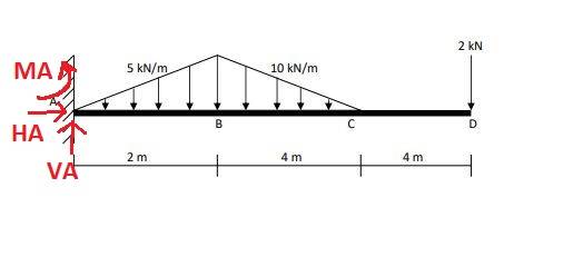

I was asked to find the shear force diagram and bending moment diagram for this load combination...But , i have problem of getting the BMD now . i am not sure which part is wrong , can anyone point out ?
MA = 5(2)(1/2)(2/3 x 2) + [ (10x4x4) - (10x4x0.5x(2+(2/3)(4)) ] +2(10)
, thus MA = 73.33kNm.
For , VA , i gt (5 x 2/2) + (10x4/2) + 2 = 27kN

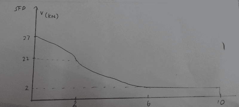

I have sketched the SFD as attached , but i have problem of finding the area below the SFD to get moment , how to do this ?

There seems to be something wrong with the original figure. If you have a region of 5 kN/m it should be a rectangular region, not a triangle. Same for the 10 kN/m. Or is the 5 kN/m at the peak of the triangle, and the load distribution is non- uniform?
From my experience, the 5 kN/m force represents the peak of the triangle.

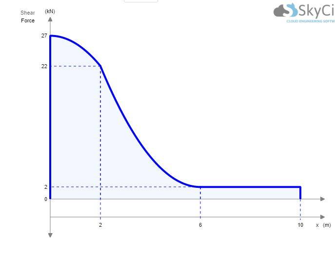

I verified this using an online calculator.
https://skyciv.com/free-beam-calculator/

Thanks for your answer , i have obtained the SFD as in the online calculator , but i have no idea to get the area under the SFD to get the BMd. Do you know how to get the area under the SFD so that i can plot BMD based on SFD ?

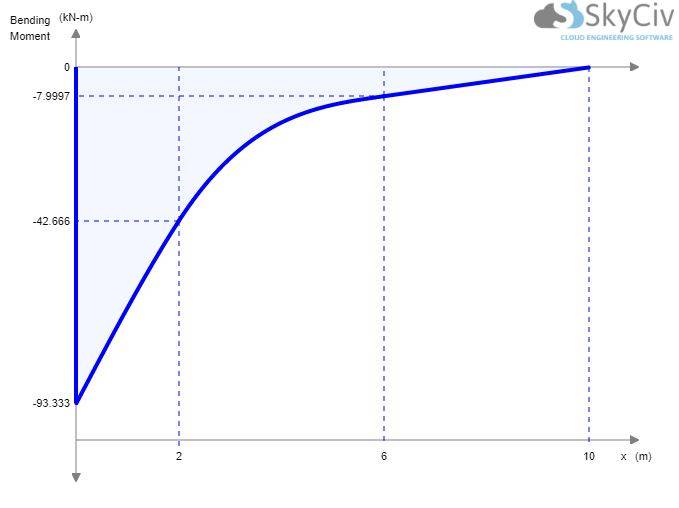

@Chestermiller @CivilSigma here's my working ... At x = 6m , i get M = -61kNm , but not -8kNm as provided by the online calculator , which part of my working is wrong ? for x = 0 and x = 2 , i gt the M value same as the online calculator

I can't make out what you have written in the photo. But, first of all, for the direction of the moment you have drawn in your original figure, I get +93.33 kNm (in agreement with @CivilSigma) rather than your -93.33. For the shear force, I get the following:
##V=-1.25x^2+27## for (0<x<2)
##V=1.25x^2-15x+47## for (2<x<6)
I integrate to get the moment variation $$M=93.33-\int_0^x{V(x')dx'}$$
This gives me:
##M=93.33-27x+\frac{1.25x^3}{3}## for (0<x<2)
##M=110-47x+7.5x^2-\frac{1.25x^3}{3}## for (2<x<6)
This gives values for M of 42.67 kNm at x = 2 and 8 kNm at x = 6
