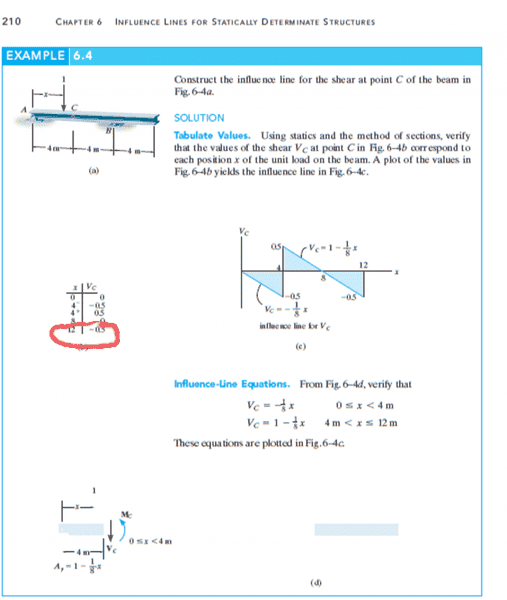

why at C . the shear force V change from -0.5 to 0.5 ? We wantg to determine the shear force at different location , and a unit force is applied at arbitary location ( measured from A) ...
IMO , there's no upwards force of 1 acting exactly on C , so the shear force will decrease from -0.5 at C to the cantilever end .

When you apply the virtual load of 1 kN at C, it causes different shear values when analyzing the beam using the right and left segments when cut. Also, note that the magnitude of the influence line at point C from the influence line graph is: 0.5 - (-0.5) = 1 which represents the unit load applied at C.
There are at least two ways of learning about influence lines. The first way is algebraic, as given in the solution quoted. If you have learned about shear force diagrams before coming to influence lines, it is easy to get the two things confused. It is necessary to keep returning to the definition of an influence line to remind yourself that it is NOT a shear force diagram. Part of your question implies you may have taken on this confusion.
The second way of learning about influence lines is to sketch the deflected shape of the beam when a unit displcement is given at the point of interest. In this case, C is the point of interest. So giving the beam a unit displacement in shear at C (0.5 down, and 0.5 up in this case) gives the deflected shape of the beam as shown in the solution. You could (and should) use this approach to check a solution obtained algebraically. This approach also works for other functions such as bending moment (but that will do for the moment!)
