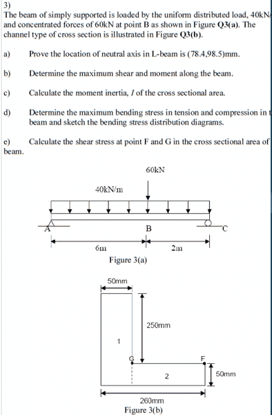

i'm not sure how to calculate the shear stress at point F and point G . I know that shear stress has formula of $$ \tau = VQ/It $$
The maximum shear force that i calculated earlier is V = 205kN , Ixx = 2.1x10^-4
for Q at $$\tau$$ at F , i have (205x10^3)(260x10^-3)(50x10^-3)(98.5-25)(10^-3) / (2.1x10^-4)(260x10^-3)
for Q at $$\tau$$ at G , i have (205x10^3)(250x10^-3)(50x10^-3)(50+125-98.5)(10^-3) / (2.1x10^-4)(260x10^-3)
Is my ans correct ?
Is my ans correct ?
I'm not sure whether my Q , and t correct or not . Can anybody check for me ?

At G, you should be looking at the web thickness for vert shear stress at horiz cut, otherwise ok. At F , however, you should be taking a vertical cut for horiz shear stress determination.
