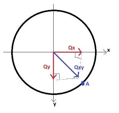

I have a truncated cone under bending on two axes.
I take a section where I have two acting side forces - Qx & Qy
I want to find shear stresses acting in the point A which is on a circumstance of the section 45° between axes X and Y. I independently calculate sheer stress from force Qx -> τx and Qy -> τy. The resultant shear force will be τxy.
On the other hand, I can in the begging take the resultant side force of Qx & Qy -> Qxy.
The direction of this force will be 45° to axes X and Y.
In this case there will be no shear stress at point A
So which assumption is correct? Why are these different?

Yes, forgot to mention, in my case Qx = Qy.
The shear force (say Qx) is a sum (integral) of all distributed shear stresses in the section in this (x) direction.
The distributions of these shear stresses is as follows - max in the centre and 0 in the furthest point of cross section along direction x.
(http://www.nptel.ac.in/courses/Webcourse-contents/IIT-ROORKEE/strength%20of%20materials/lects%20&%20picts/image/lect28%20and%2029/lecture%2028%20and%2029.htm)
Am I wrong?
The tricky bit is if I can substitute Qx & Qy with resultant Qxy and if so, why there's such a difference in result?
In case of Qx & Qy - in point A there should be shear stress present, however if I substitute Qx & Qy I get Qxy and point A in this case is the very end of the section in the direction where side force Qxy is pointing.

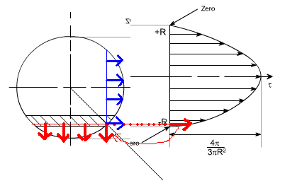

Ok, Here's everything in detail.
Please find attached shear stress distribution along Y axis due to side force Qy (don't pay attention to blue arrows yet)
Based on this, there is a shear stress τx acting on the line (marked red).
Point A (see previous pictures) belongs to this line, therefore if we consider point A as a small area dS, the shear force acting in this are will be τx.
The same goes for side force Qx (shear stress - marked blue)
Do we agree up until now?
Now what I was suggesting is replacing both forces Qx and Qy with resultant force Qxy (due to Qx = Qy, it'll be acting 45° between axis X and Y)
The shear force distribution along this ONE force should be similar, meaning there should be no shear force at point A (since it's the most far point along force Qxy)

Still don't get it. Maybe it would help if you could represent the shear stresses as a function of x and y analytically.
Chet

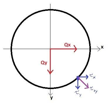

Dear Chet,
Ok, I'll simplify the problem.
You have a beam fixed with one end to the ground with a cross section along the beam of a circle with a radius r = 1 m
There are two forces acting at the free end of the beam perpendicular to the length of the beam Qx = Qy = 200 N (end perpendicular between themeselves obviously)
Have to calculate shear stress at point A that's located on the sircumfurance of the end section at angle 45° (as in my previous cases)
Do I calculate these independantly for Qx and Qy (meaning firstly I calculate shear stres at point A as if only force Qx is present, then as if only force Qy is present; then sum up the vectors) or do I make a resultant force Qxy (sum of these vectors with value = square root of (Qx2 + Qy2) ) and calculate it for this case?
You obviously get the different results. At least I do.

Say I have two equal forces Qx and Qy acting perpendicular.
At point A (as usual) I would have distance x and y for the formula = r * cos45°
As a result I would have some shear stress value in X and in Y direction.
HOWEVER, if I substitute Qx and Qy with a resultant force Qxy = sqrt(Qx^2 + Qy^2), I will have instead of "x" value r or d/2.
However, if I insert d/2 in the formula instead of the x I will have 0 in the bracket and as a result τ will be 0.
So why is it 0 if in the previous case I got τx and τy not 0? And a resultant of those two will not be 0 also

As best I can tell, what you are saying is:
$$τ_y=Q_yf(y)$$
$$τ_x=Q_xf(x)$$
where ##f(ξ)=\frac{4}{3A}\left(1-\left(\frac{2ξ}{d}\right)^2\right)##, with ξ representing a dummy variable. So,
$$τ=\sqrt{τ_y^2+τ_x^2}=\sqrt{Q_y^2f^2(y)+Q_x^2f^2(x)}$$
But, I think you are also trying to say that:
$$τ=\sqrt{Q_y^2+Q_x^2}f(\sqrt{x^2+y^2})$$
But, the latter is just not correct algebraically.
If I'm misunderstanding, I apologize.

The first approach is correct, and the second approach is not correct.
Is there a reason I can't substitute both side forces by one?
I don't quite know how to explain to you why the second approach is incorrect. It all depends on what motivated you to think that it could be correct. I personally would not have expected it to be correct. So what was your rationale?
