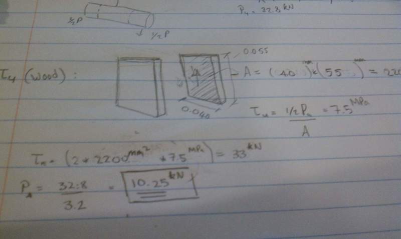

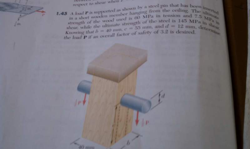

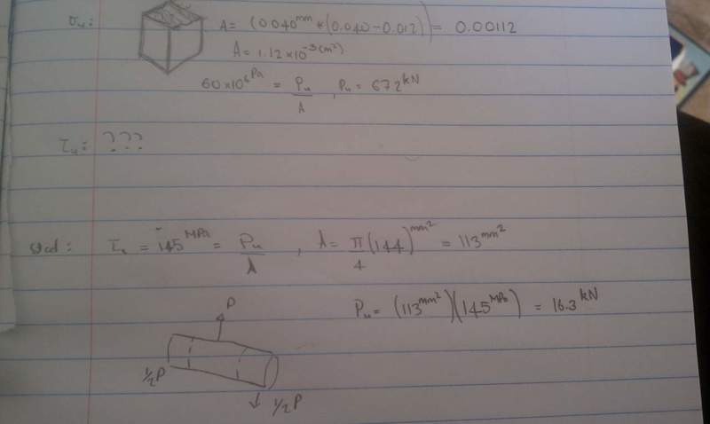

[itex]\sigma[/itex] = F/A
I understand that I should evaluate the different forms of stress to find different values of the ultimate load. I also understand that I should choose the smallest value among them since anything greater than the smallest value will cause failure.
I know how to calculate the normal stress in the block and the shear stress in the steel.
I don't understand where shear stress occurs in the block and thus how to calculate it.
