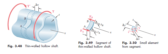

Now I'm reading part THIN-WALLED HOLLOW SHAFTS
The book says this
We now detach a small element from the wall portion AB (Fig. 201 3.50). Since the upper and lower faces of this element are part of the free surface of the hollow member, the stresses on these faces are equal to zero.
Why its surface is free?
For the case with a bar the book from the fact that surface is free concludes that shear stress are all zero on the edges.
The book says this
The surface of the shaft at the portion AB and the corresponding surface located below AB by the thickness of the outer wall are free surfaces for the simple reason they are not restrained in any way.
However, when the book says that the stresses on these faces are equal to zero, it fails to emphasize that the axial and bending stresses are zero, since the shaft is in pure torsion. More generally, the net axial force acting on the shaft is zero.
Equilibrium considerations require that FA + FB = 0, and the same will apply to the shearing forces acting along arc AB and the corresponding arc located Δx away. Those shearing forces have magnitude τ ⋅ t ⋅ Δs, using the diagram in Fig. 3.50. For thin-walled structures, it is assumed that the shearing stress τ is constant across the thickness t of the wall.
The shearing stresses in the wall are acting in a plane which is perpendicular to the axis of twist, so there will be no axial force component created by them, and the axial stresses acting on the free surfaces of the shaft remain equal to zero.

Chestermiller said:
Which shear component of the stress tensor are you talking about? Certainly on an element of area on the surface of the bar, the air exerts no component of stress tangent to the surface.
Thank you for the reply. But we have shear stress in the middle of bar side. The problem for me is that regarding edges the author says that surface is free and he concludes from it that shear stresses are zeros there. But why then surface is not free in the middle of bar side? Certainly, the air 'exerts' the same tangent stress there.
Revelation: Woow, can it be because surface in the middle of bar is curved and near the edges is not?
Shear stress is not something which is acting between the bar surface and the air - it is something acting within the material of the bar .
Consider a little cube of material in the outer surface of the bar .
When a torsion load is applied the bar twists and the cube becomes distorted .
(1) What stresses must then be acting on the faces of the cube ?
(2) How do these stresses vary depending on where the cube is located ?
