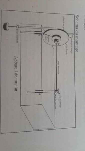

We had this elementary experiment in class. An aluminium rod is fixed at one end and at the other end you have a disk. You hand increasingly heavy weights on the disk and measure how much the rod shears (twists). We were asked to make a graph of the shear torque vs. angle of torsion. It came out quadratic. I'm trying to figure out why, physically and mathematically.

Not sure I understand the set up. Is the rod horizontal? Is the plane of the disc normal to the rod, with the rod attached at its centre? Are weights attached at the rim of the disc, at the same horizontal height as its centre?
Where do the oscillations come in? The problem description makes it sound static.
Sorry about that. The rod is horizontal and normal to the plane of the disc, attached at it's centre. Weights are attached at the rim of the disc but not at the same height as its centre, lower rather (measure not taken). When you hang a weight, the disc rotates (its rim is graduated in mm) but then it oscillates back and forth (counter-rotation and back) then it stops. That's when you read the displacement in mm and convert them to rads.

haruspex said:
the weight does not have the same horizontal distance from the rod.
Seeing the diagram, it looks like the weights are attached to a band which wraps around the top of the disc. If so, the point of application of the weight is always on the level of the disc centre.
kamhogo said:
at the location of the twist. At that location, it becomes easier and easier to twist it:
The twist is distributed all along the rod. It behaves like a spring, the greater the twist the greater the torque.
