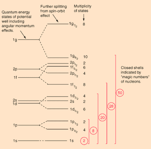

The shell model is given by:
So for Li, 3 protons pair up with 3 neutrons, leaving an unpaired neutron in ##1p_{\frac{3}{2}}##. Thus S = 3/2. It's parity is odd.
For Oxygen, 8 protons pair up with 8 neutrons, leaving the unpaired neutron at ##1d_{\frac{5}{2}}##. Thus S = 5/2. Parity is odd.
For Neon, 10 protons pair up with 10 neutrons. it's even-even. Parity is even.
For Aluminium, 13 protons pair up with 13 neutrons, leaving the unpaired neutron is in ##1d_{\frac{5}{2}}##. Thus S = 5/2. Parity is odd.
For Nitrogen, 7 protons pair up with 7 neutrons. No unpaired?
For Potassium, 19 protons pair up with 19 neutrons, leaving unpaired neutron at ##1d_{\frac{3}{2}}##.
For Scandium, 20 protons pair up with 20 neutrons, leaving unpaired proton at ##1f_{\frac{7}{2}}##.
Protons don't pair up with neutrons, they are different particles. Protons can pair up with protons, and neutrons with neutrons.
OK, I got it. How do you determine the parity then? Say for Oxygen, there is 1 unpaired neutron in 1d(5/2). What is its parity?
