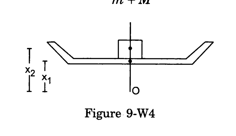

A cubical block of ice of mass m and edge L is placed in
a large tray of mass M. If the ice melts, how far does the
center of mass of the system "ice plus tray" come down ?
What I thought was that if no net force is acting on the system then position of center of mass should not change. But the answer in my text is mL/2(m+M). Can somebody explain me why is there a shift in center of mass.

carlyn medona said:
no net force
You are making an unwarranted assumption about the normal force on the ice from the tray.
the normal force and weight is balanced right?
For a mass that is not accelerating vertically that is true. But when the ice on the top melts, what happens?

Try answering the question I posed. Consider a small piece of ice high up on one side of the block. What happens when it melts?

How does the melted piece reach the tray?
Okay so the melted water comes down because of net downward force, which implies normal force is less than weight. So what is the net force on the system?
Consider the forces between the melted fragment and the solid block.

A fragment of the ice, high up on one side of the block, is stationary. Then it melts, and we know it ends up on the tray. By what process does it get from the top of the block to the bottom? It is a very simple question, with a very simple answer.

I wasn't looking for a force analysis at this stage, just "it runs down".
The point is that it goes from stationary to moving. What does that tell you, in general terms, about the forces on it?

That there is a net downward force on the molten ice .
Right. So what is the affect on the normal force between the tray and the block?
