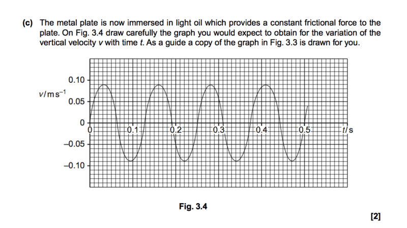

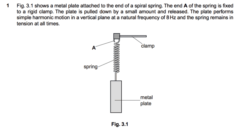

Hello, I don't get it why does the frequency not decrease? As this i assume is damping and frequency must change.
And why do only positive peaks decrease?2 Not sure about equations needed.
3.I thought that as it is damped, Energy is lost as heat. Thus speed decreases, therefore, it takes a longer time to complete an oscillation.Thus, frequency decreases, however, the mark scheme says that it is constant
The part about decreasing peaks is due to damping(I assume) but I do not have a clue why only positive peaks decrease.
Please help, I am very confused. Thanks

Why would the frequency decrease? For a harmonic oscillator frequency is independent of amplitude.
thanks for your reply.
can you please help me with the 2 bit? why only +ve peaks decrease?
Dima Petrukhin said:
... only +ve peaks decrease?
Where are you getting this?
